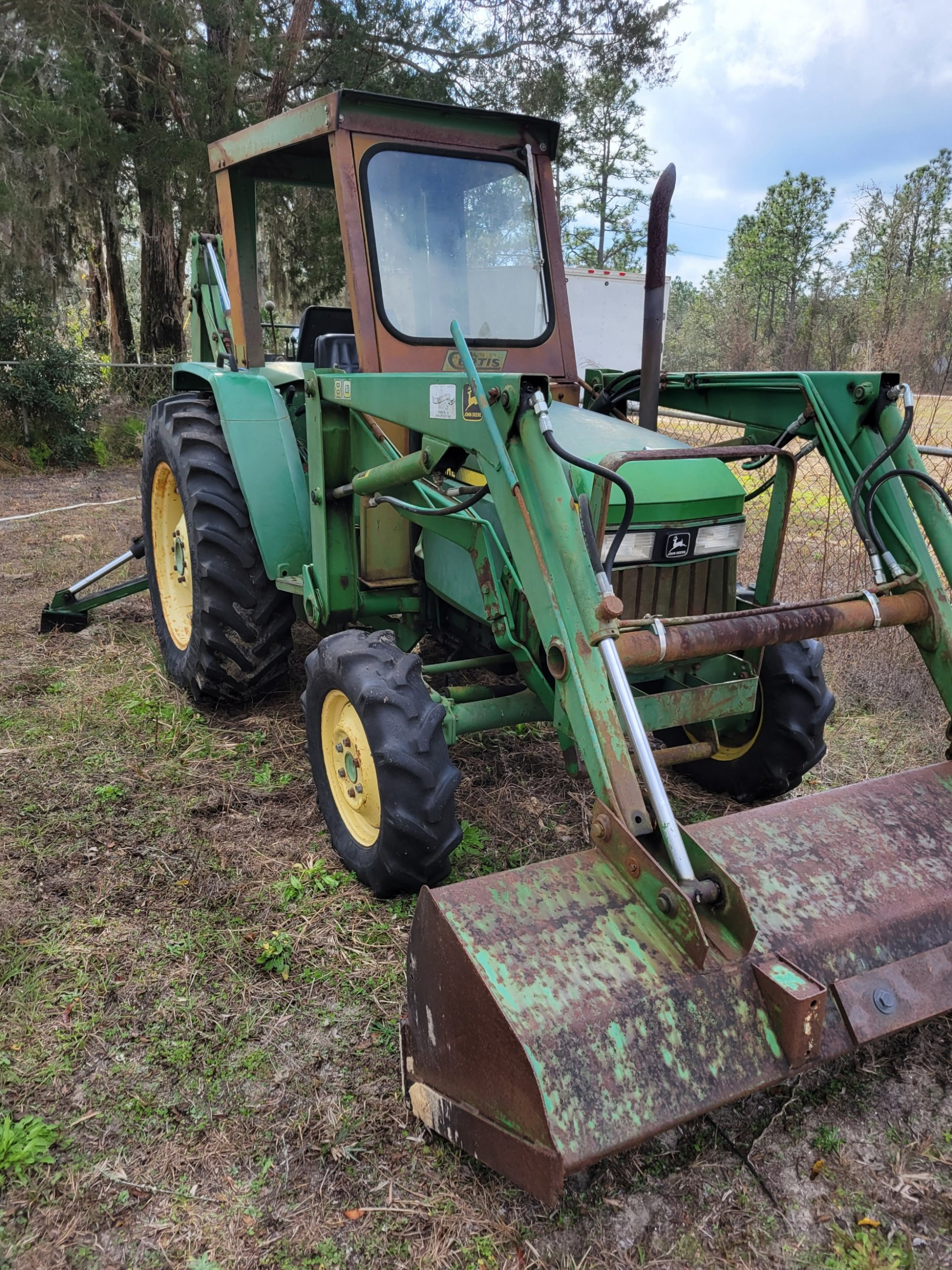

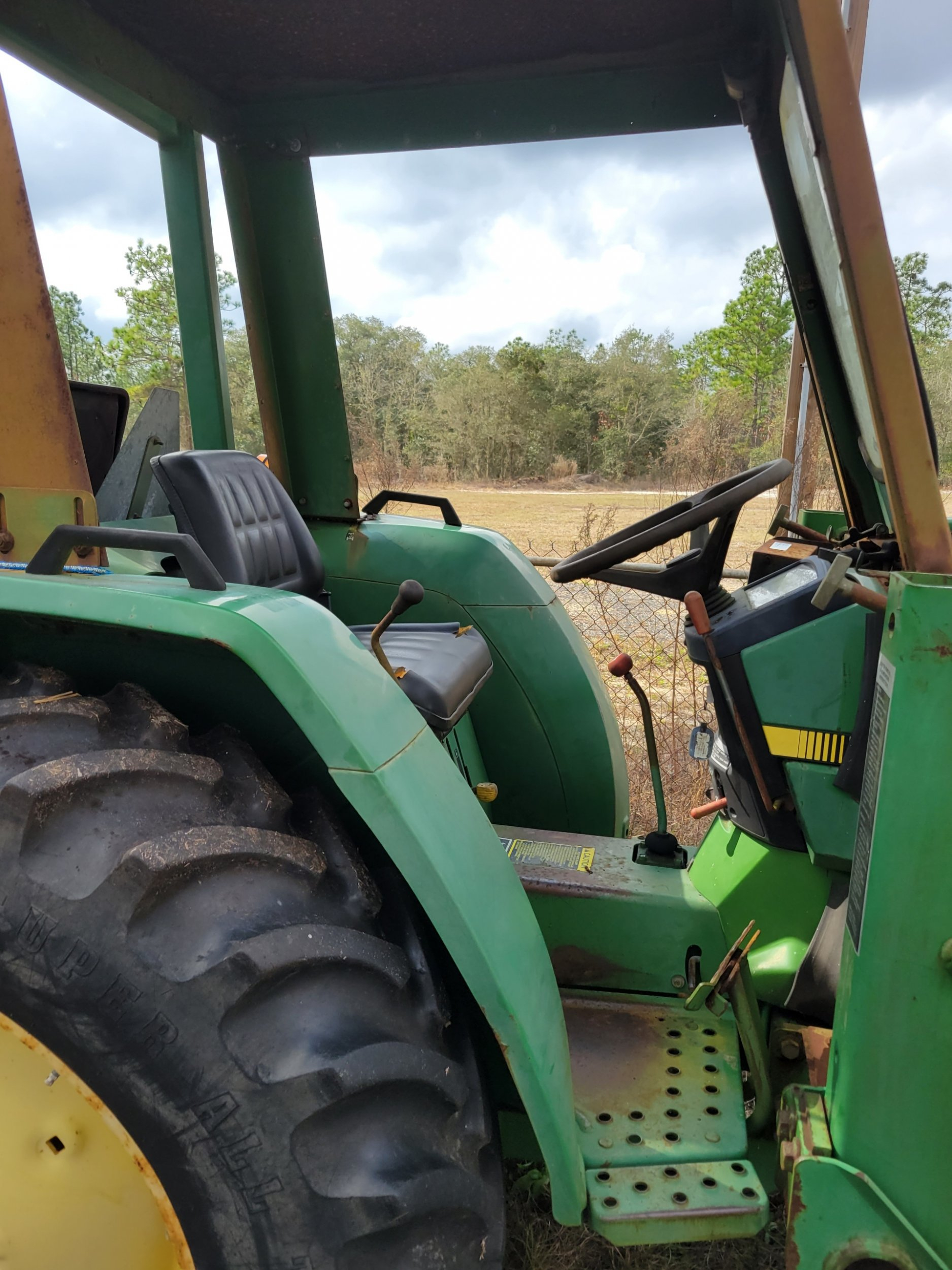

John deere 1070
I'm new to the tractor market but need something to do some work and maintenance on a property I bought and will be building a couple houses. My buddys neighbor has a 93 john deere 1070 that's he's looking to part with. It wasn't used much and has 770 hours. It comes with a front loader, extra bucket that's new. A bush hog, post hole digger. Box blade and a backhoe. And I believe he has a new set of front tires.
It fired right up, and seemed to run great. Paints a little rough looking. I was thinking of making an offer but not exactly sure where to start. I've been looking at prices online but most are auctions so hard to get a good baseline. My pan would be to use it for about a year and sell after the houses are done

Your pictures aren't showing up for me, but I would think that machine with loader and 4x4 would be in the neighborhood of 12-14k in good condition. Backhoe and additional implements maybe another 5k, but that's just a rough guess.
Pre Tier4 (emissions) machines are selling at a premium.

Actually for a 30 year old tractor stored outside it's in average condition, add on cab makes it look more worn. That 1070 is a hidden gem with those low hours. I would offer 10k and see what their response is. Cleaned up and good tires in today's market it's a 15k tractor all day.
