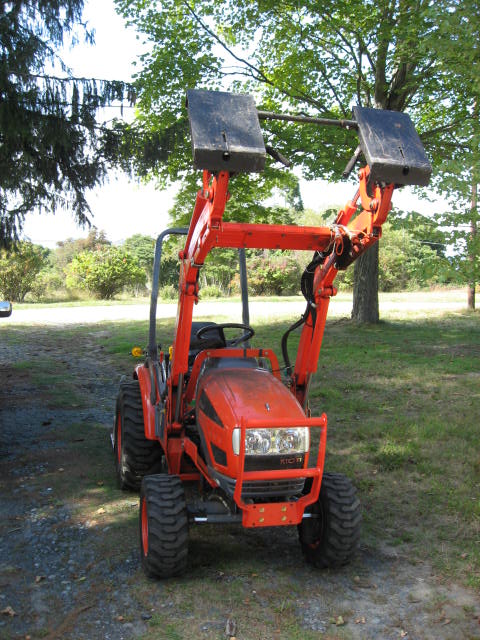

Island I love that brush grapple you have on your tractor. Now I see it is not quick tach set up. Do you have a bucket and drive the pins out of the loader or do you never take that off
   / What To Get? #27
Actually it is a quick attach. Here is a photo of the FEL "naked". The grapple is from Millonzi and I don't know the manufacturer of the QA adapter but I got it through Millonzi.
I have left it on the tractor for most of the summer as I'm clearing brush.
   / What To Get? #28
no kidding I thought for sure it wasn't. I have to admit that is a real pretty tractor. I thought it was bigger than a 20 horse mostly because it seems to have the features of a bigger tractor like the piston linkage are the quik tach
