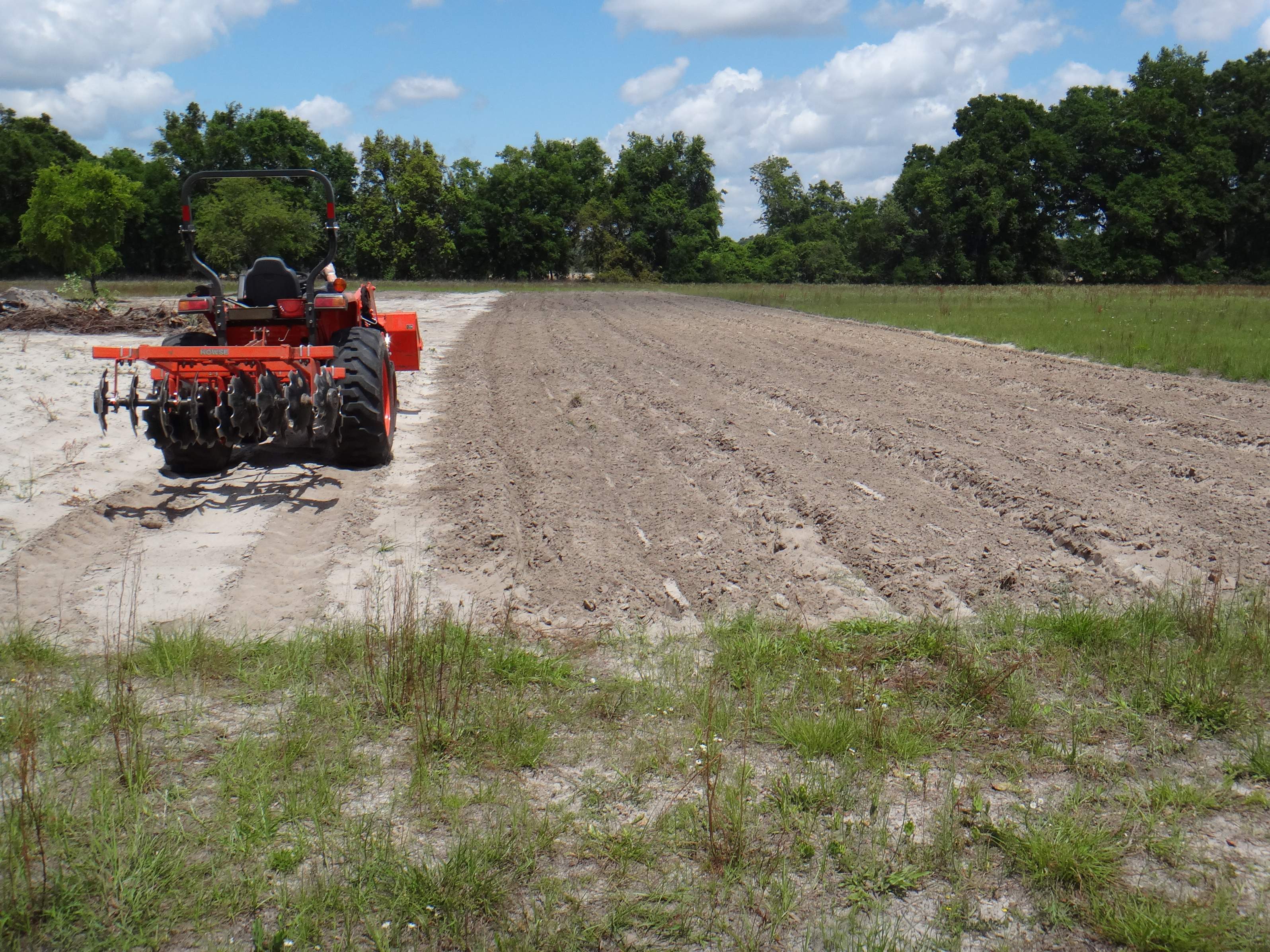

Food plot seeds are generally eager germinators and the seed is relatively cheap.

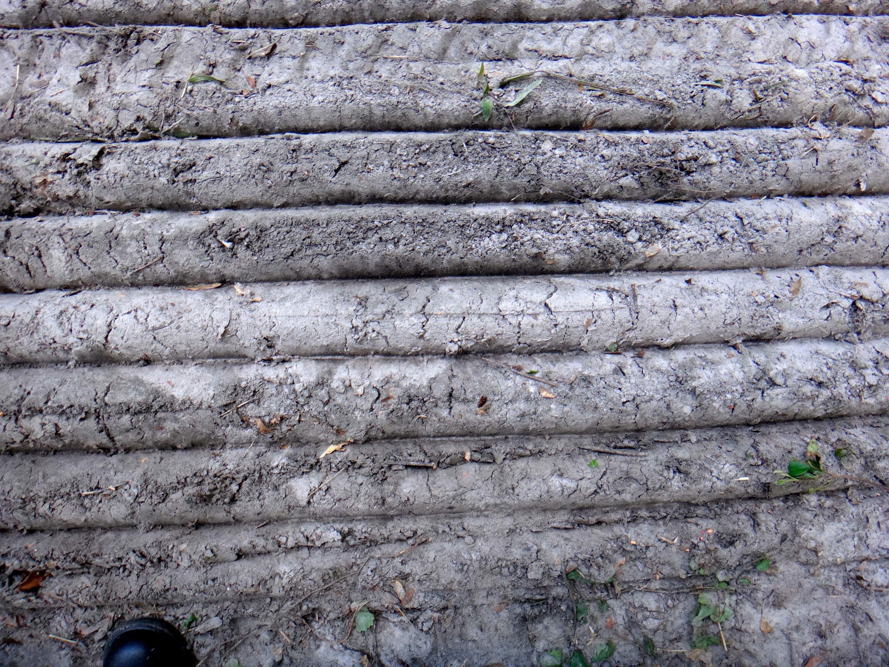

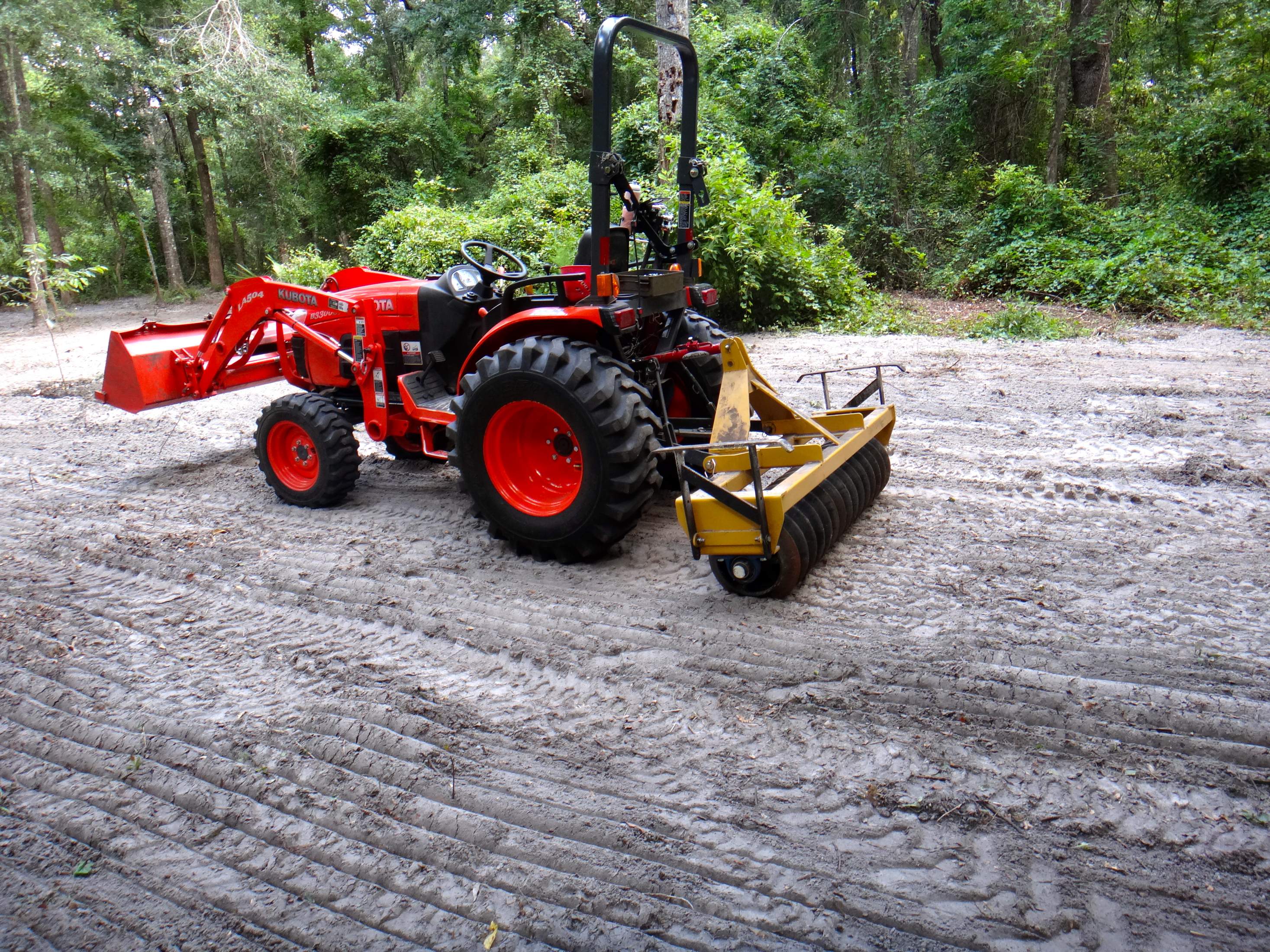

I use a Disc Harrow to scratch open the ground, spread a little fertilizer and supplemental Boron sometimes, sow the seed and roll in with a Cultipacker.

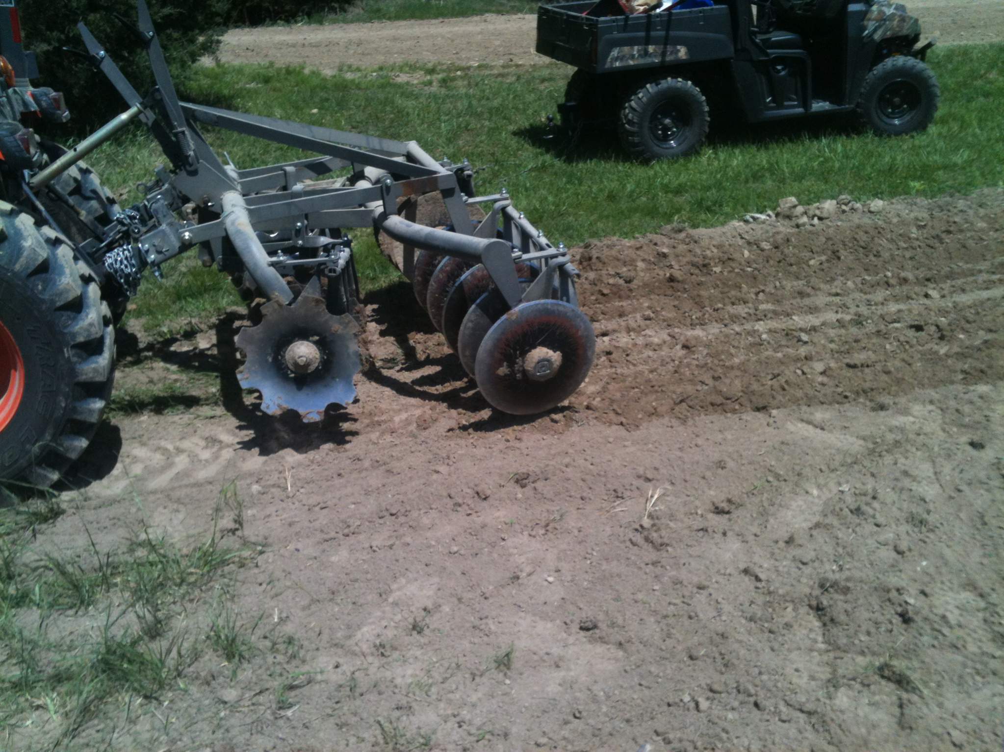

Get enough Disc Harrow. You need 20" diameter pans to have enough weight to do good. You would be better off with 22" diameter pans and could pull 24" diameter pans with the DK40 if you want to. The heavier pans will not break when working rocky soil except under freak conditions. You have to pay for weight, though.
Disc Harrow is from Howse. Cultipacker is from Everythingattachments.com
DISC HARROW SELECTION:
http://www.tractorbynet.com/forums/attachments/308251-disc-harrow-selection-18-45-a.html?highlight=

In a few small areas where there was Bahia pasture grass sod, I broke the sod with a Moldboard Plow, then used the Disc Harrow to smooth. Plowed food plot area represents 10% of my food plot area. The other 90% I used only the Disc Harrow with two or three passes the first time I disc. As I live in Florida, I normally plant distinct Spring/Summer and Fall/Winter food plots so the plots get disced twice per year, one pass only per season, and stay soft. I sow a little thick; the local Ace Hardware sells Spring/Summer and Fall/Winter food plot seed for $22/fifty pounds.
Learning to adjust a Moldboard Plow is rather tricky. Plowing on sloping ground is REALLY tricky and I do not recommend it. Heck, finding a used Moldboard plow, complete and in good condition is difficult. It is difficult today to find replacement parts for the "wear" parts on Moldboard Plows.
A Disc Plow (which is NOT a Disc Harrow) would be my choice of plow for food plots if I were beginning now. Disc Plows are less prone to "hang up" on rocks and tree roots and are safer on slopes. Monroe Tufline still manufactures Disc Plows. Used Disc Plows show up on eBay all the time. Ken Sweet at Sweet Tractor in Canmer, KY., usually has refurbished Disc Plows which he sells on eBay.
Neither a Disc Plow nor a Disc Harrow is very good at cutting genuine sod. For that specialized task a Moldboard Plow excels.
Often people plow because their Disc Harrow is too light. There is kind of a magic number for Three Point Hitch mounted Disc Harrow general use effectiveness: 40 pounds total Disc Harrow weight bearing on each disc/pan. A Disc Harrow with 18" diameter pans barely makes 40 pounds, yet people buy 12" - 14" - 16" pan diameter Disc Harrows.
For food plots where the land has NOT been plowed 20" pan diameter is the minimum effective and 22" and 24" pan diameter better. However, most people will not pay for the weight, instead they plow. Go with Disc Harrow 9" spacing between pans rather than 7" spacing between pans. You want scalloped pans.
I usually, not always, Bush Hog new food plot land before scratching it with the Disc Harrow.
A Cultipacker will give you a better return on investment, when planting food plots, than will a plow.
