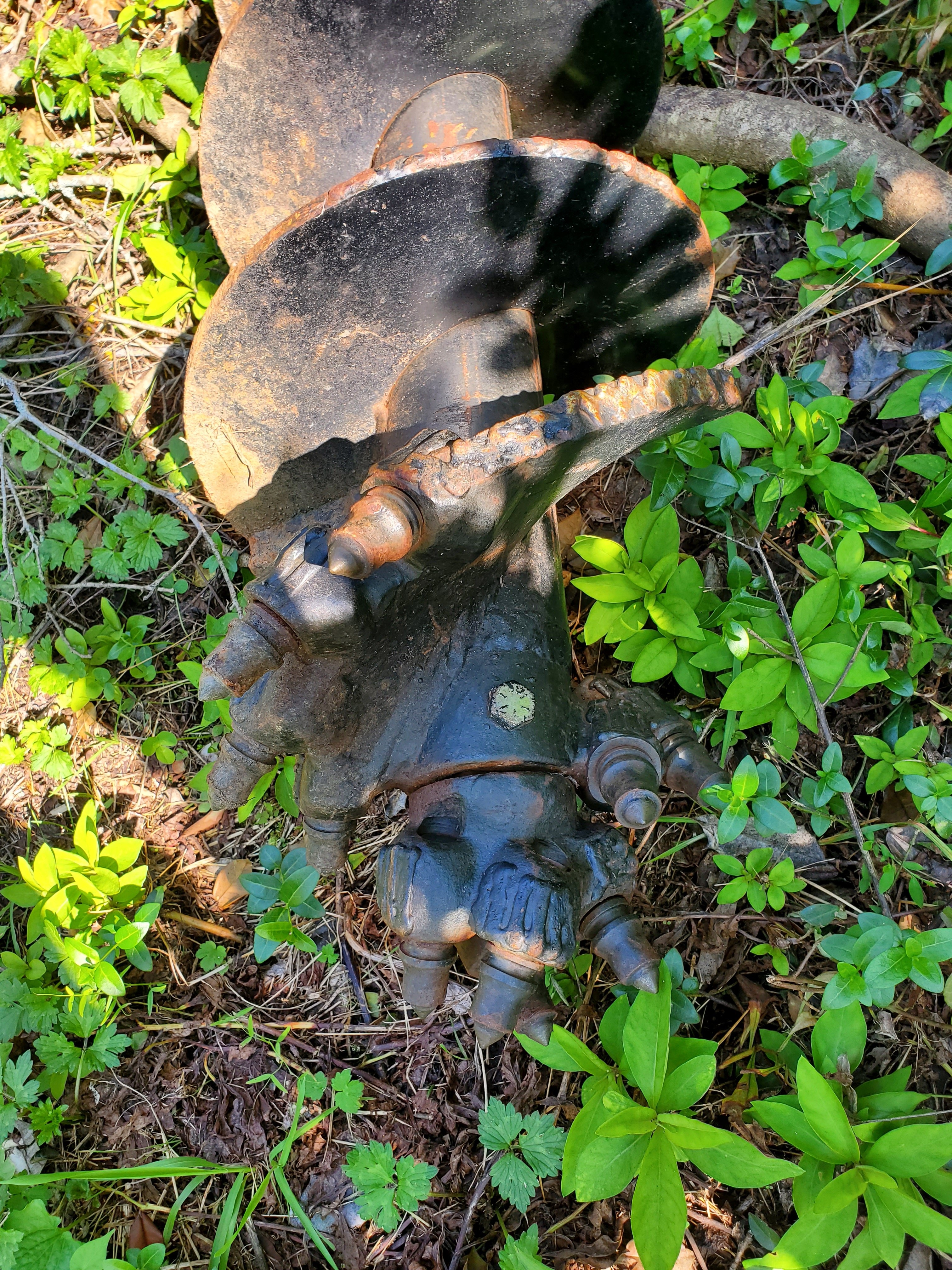

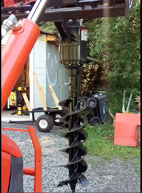

Rock augers are available and work very well in the softer stone or ground littered with hard stone. I prefer running the hydraulic driven auger off the SSQA and using the 3rd function because I can back the auger out of a jam.
Pic of rock auger with carbide points and hard facing along flight edges.
Pic of Mcmillen X1475 that I run on the M59. Loads of down pressure ( close to 5,000 Lbs) when front wheels off ground.
