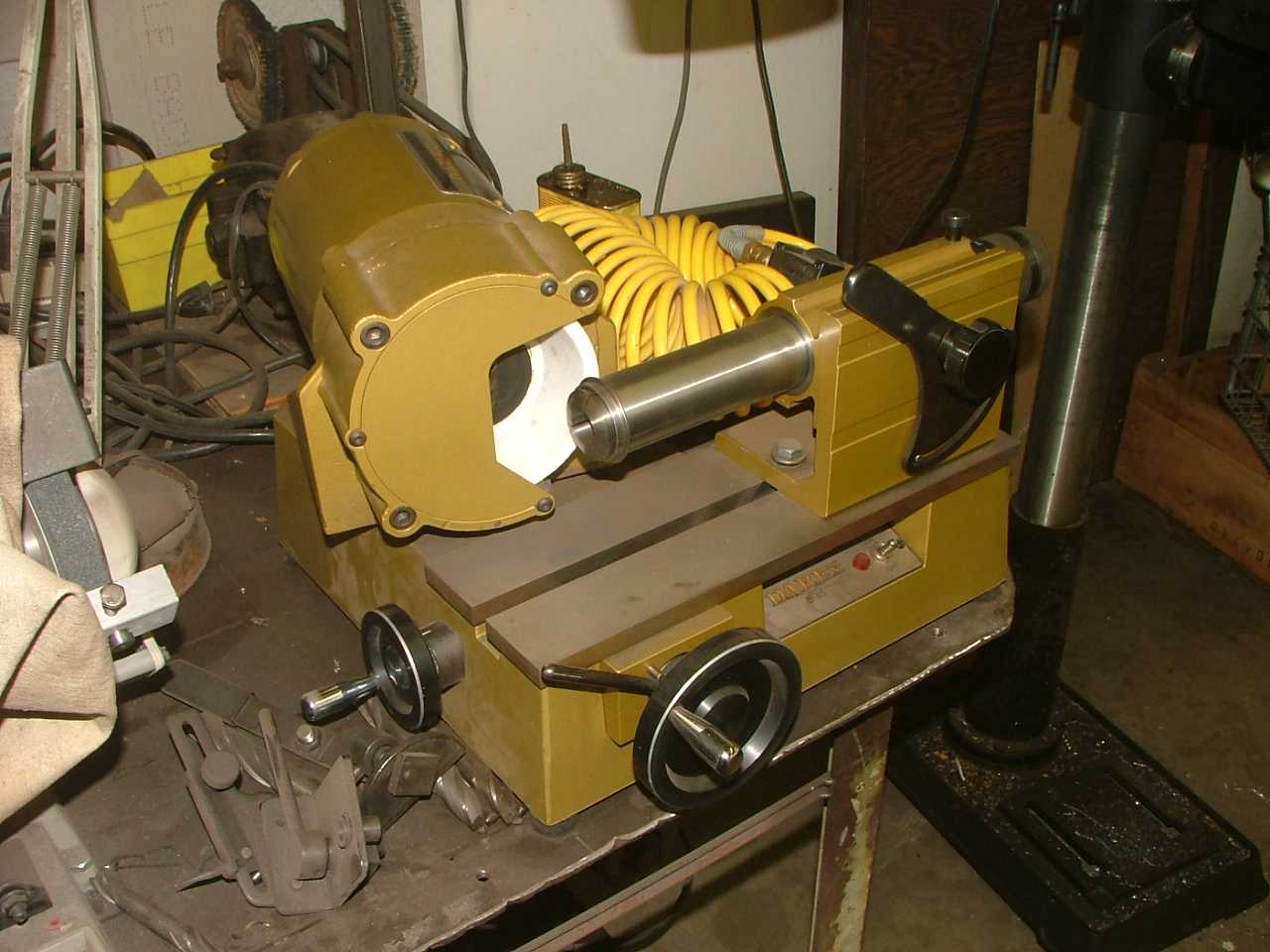

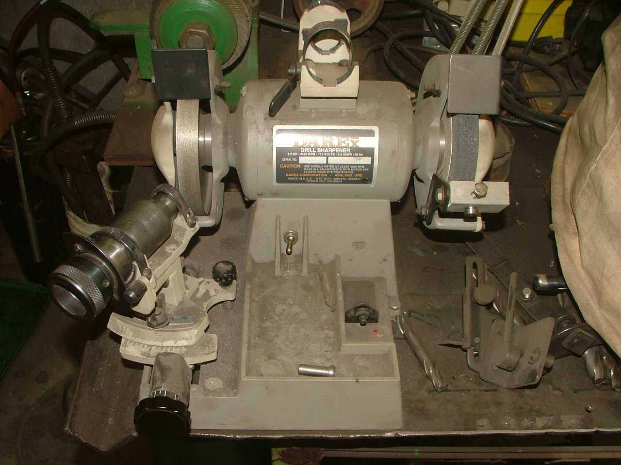

I purchased this Darex some time in the early 1990s. I don't see it listed any where so I would guess they have quit making them and went to the drill doctor that we know today. The second picture is of my endmill sharper.
Both units do an excelent job of sharping the drills and endmills.
Darex is still around and located in your neighborhood, Ashland.
My Darex is like the one in your first picture. Very nice machines but due to price, not the typ home tool.
