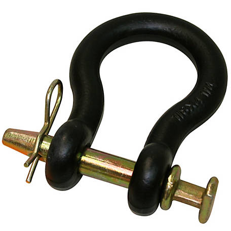

Now, with the 1066, I'm realizing we can maybe just use it. So, the tractor has a draw bar hanging out the back. If I wanted to attach a 3/8" chain to drag a stump or something.... what's the best way to attach chain to drawbar?

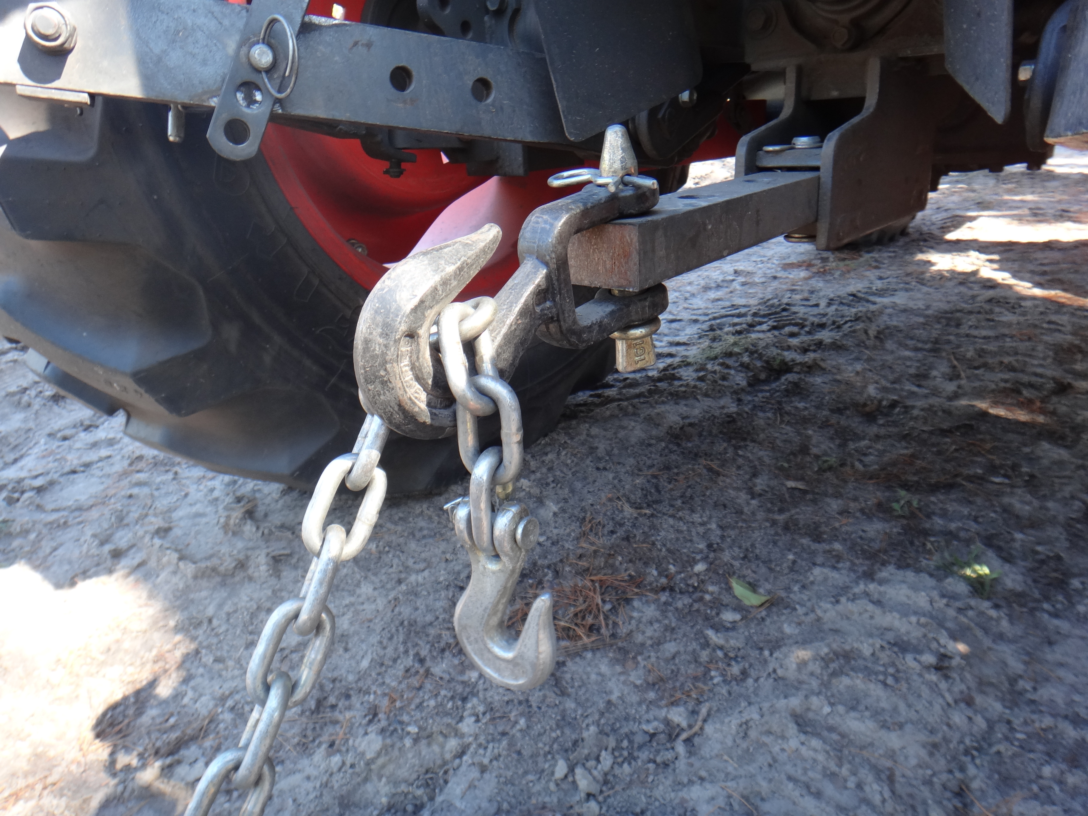

You need a $20 clevis attached Chain Grab Hook. Readily available at TSC, Rural King, Agri Supply and other ag oriented retailers.
I pull loop-end nylon straps too.

You probably want a clevis D-ring with a pin that is matched to the hole size in the drawbar. Get one with a regular pin (not screw in) that has a cotter pin or lynch pin on the bottom. These types of rings are strong and easy to use -- if you have to remove it to feed or remove a rope/chain, it's quick. Tractor Supply sells a bunch, but I think I got mine online somewhere.
The benefit of a D-ring is that it will work for rope, cable, or chain.

This is what I use on my tractors, about $20 at TSC:

Another idea is if you get shackle make sure you get one that screws in because I have had a branch or stick pull the hair pin out so you might have a chance of losing the pin. But if you use a screwing from the top less chance of it falling or get knocked out the draw bar.
