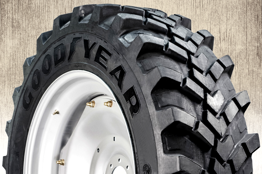

I got R4's and personally I think they're the cat's meow. They don't load up with dirt and mud like turfs, they actually tear my grass up LESS then the turfs mounted on my zero-turn, and I will go on record to say that those who ***** about them in snow DON'T KNOW HOW TO USE 4WD AND LOCKING DIFF!

I’m ok with the R4’s they sure are tough and easy on the lawn. Ride pretty rough when roading especially when it’s cold outside. I’d consider R14’s I think there’s some YT videos on the comparison.
I agree , Just plowed a mile of gravel rd and 4 long driveways covered in 10 inches of snow and ice , Loaded r4s . No chains and no problem with traction.
   / What tires should you get on a new Tractor, R1, R4, or Turf? #20
I'll go on record saying my R4's suck in snow. No lateral traction in snow/ice
Our parking area is on a slope, get a layer of packed down snow/ice and the tractor just slides sideways down the hill.
Can barely back up without sideways sliding down the hill, let alone trying to push a 9' snowplow
