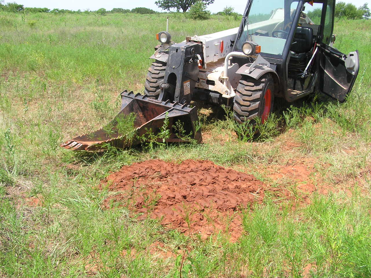

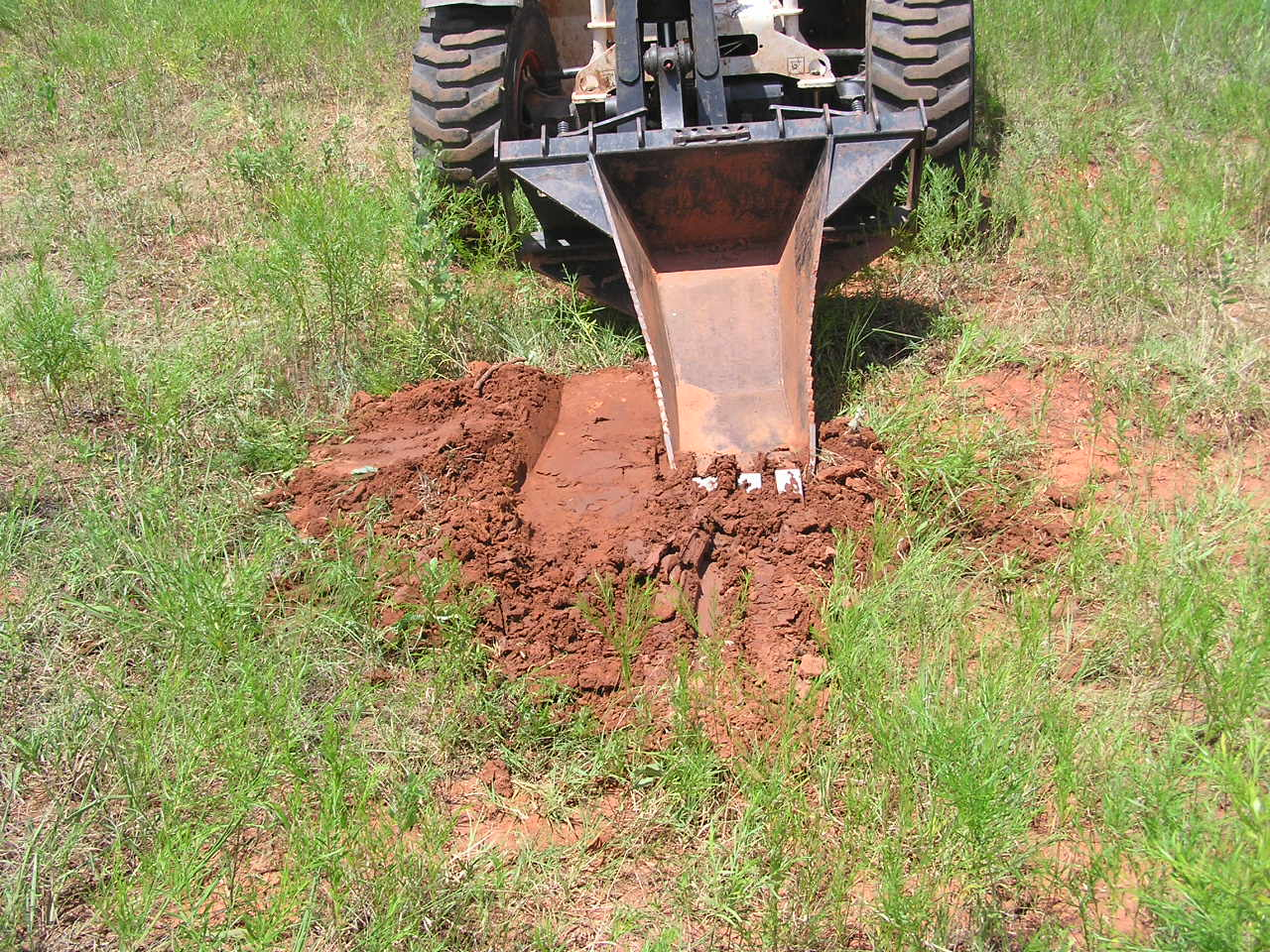

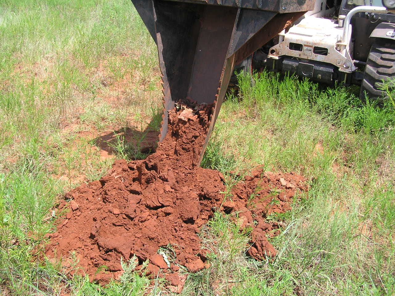

   / What Stump Bucket for MX5200 #37
I also found that this bucket is a great tool for spot filling holes. My property was a tree farm before I moved in and the prior owner had removed trees live and left the holes. It is great fun when the fields were 6' tall and you couldn't see them :(. It beats dumping 72" of dirt on a 24" hole.
Yep, here is my hole filler:

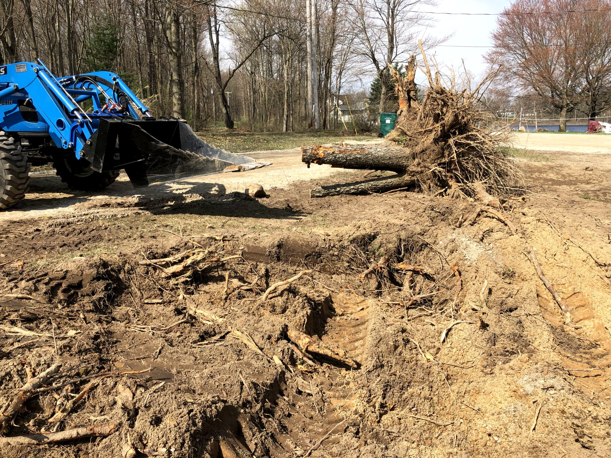

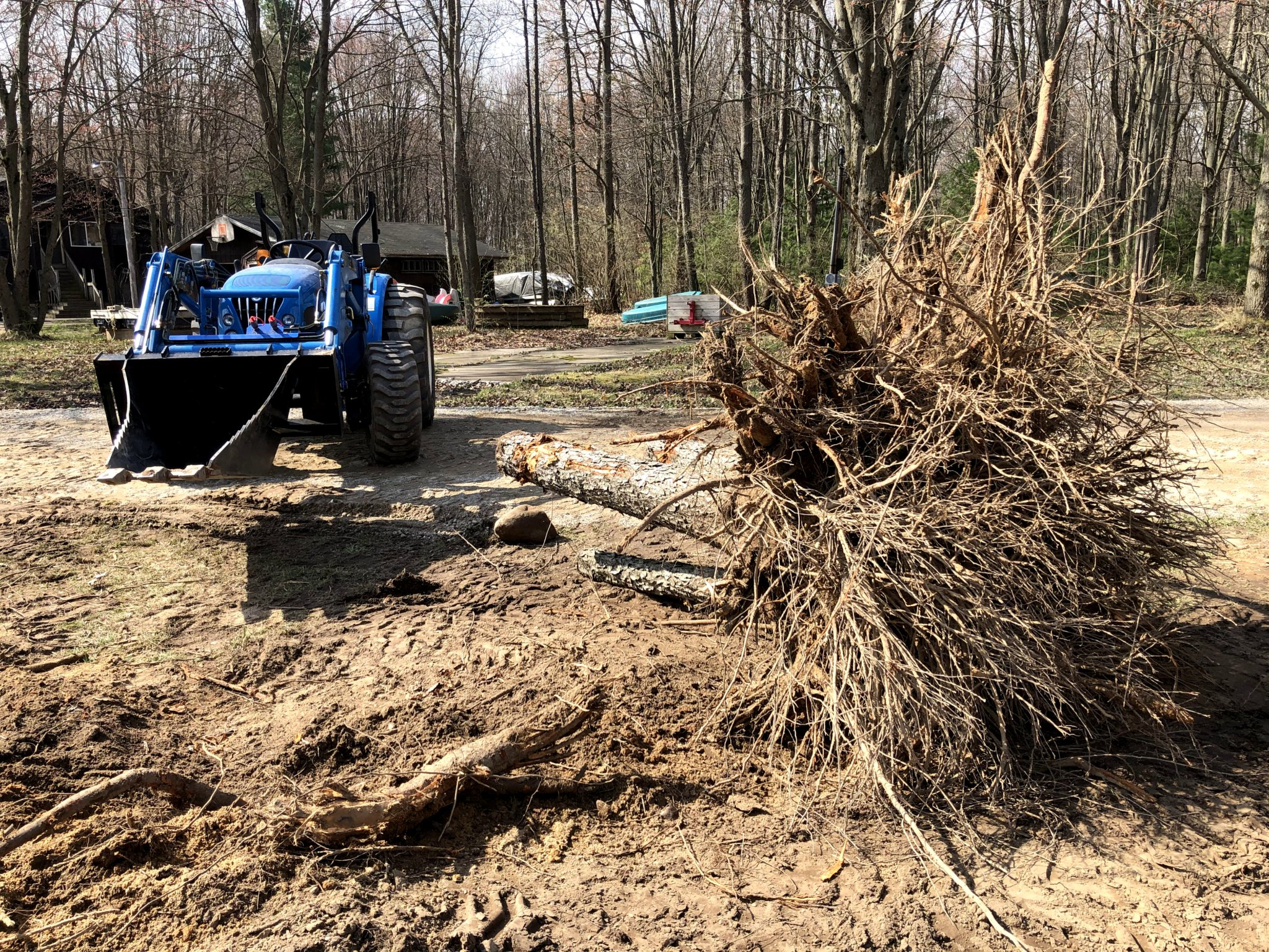

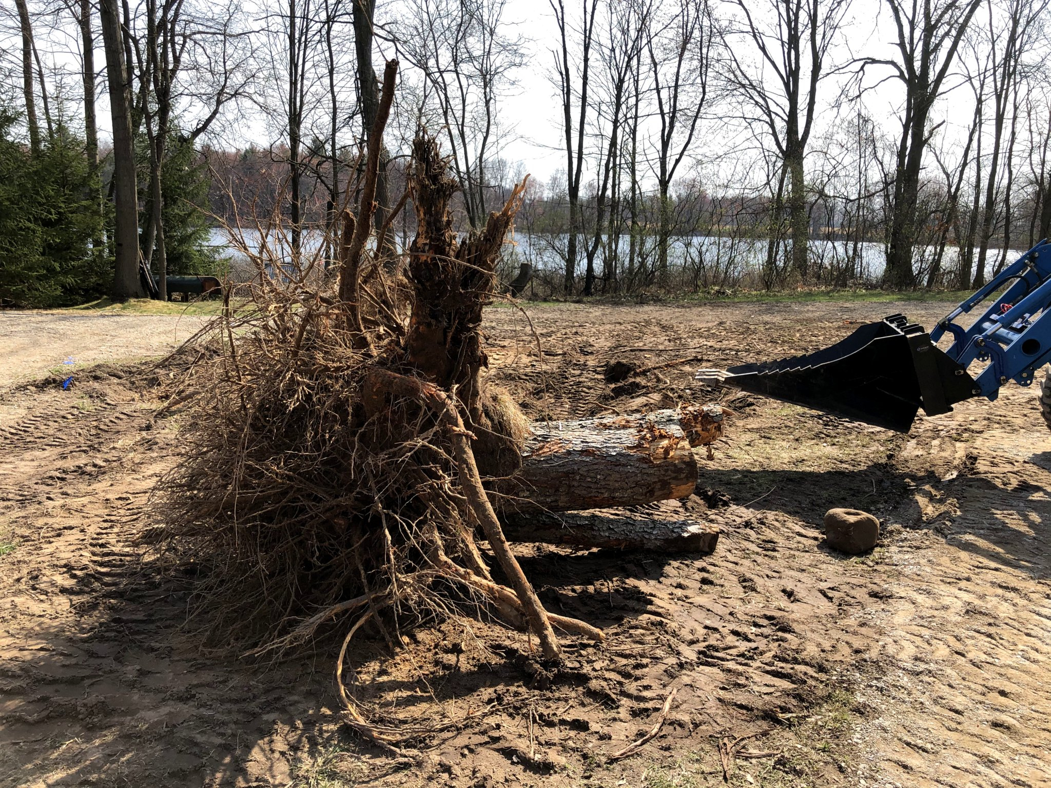

I dug about 8 stumps over 2.5 days last week with my Titan, it takes a lot of digging but if you're patient and don't get to aggressive they will come out.
These pictures are the biggest one, the others were a little smaller.
