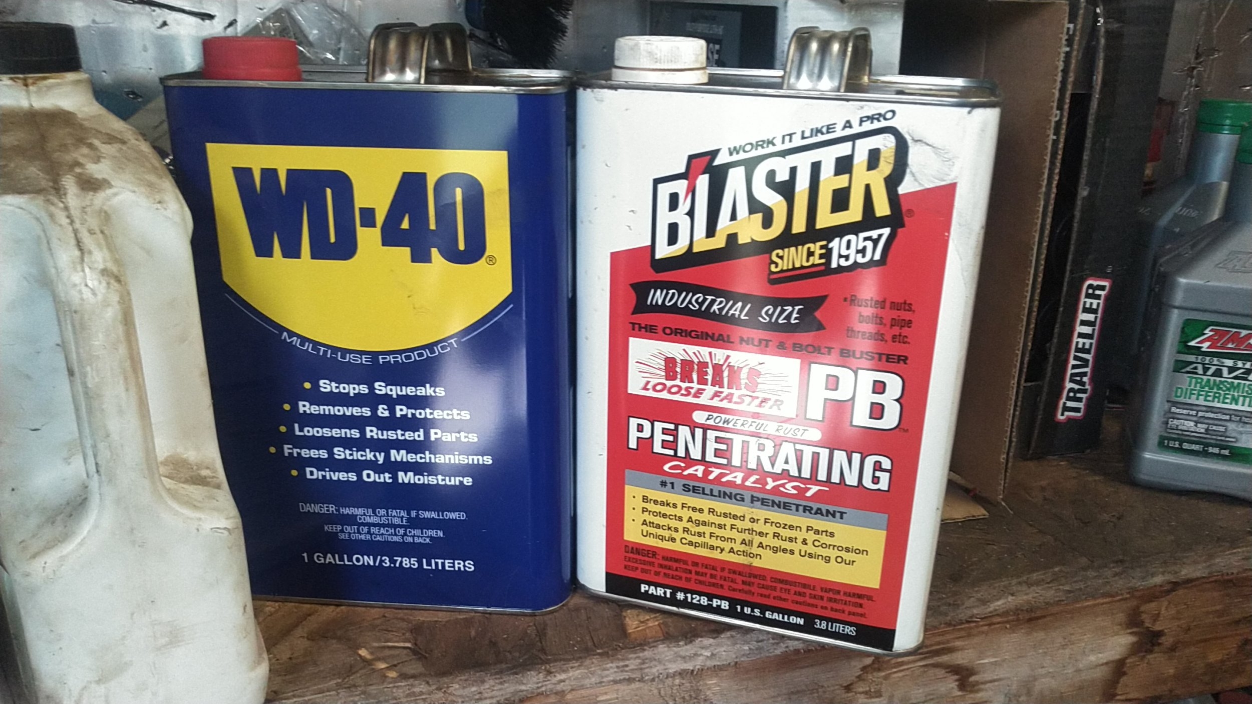

When I don't need to try and make a bearing or throttle cable, hood latch etc last beyond it's life span buying WD -40 or pb blaster by the gallon (especially when there on sale or offer discounts)is more economical for me anyway. I usually run around with a spray bottle fall and spring spritzing cables and whatnot. My go to is still what I posted earlier it's pricey but works great as a lubricant renewing cables and bearings long past there lifespan on used up well worn stuff I've acquired. I'm also a believer in atf mixed with acetone knowledge passed down from an old-timer that could fix anything. Really stubborn stuff nothing beats heat by a oxy acetylene torch in my case anyway.
