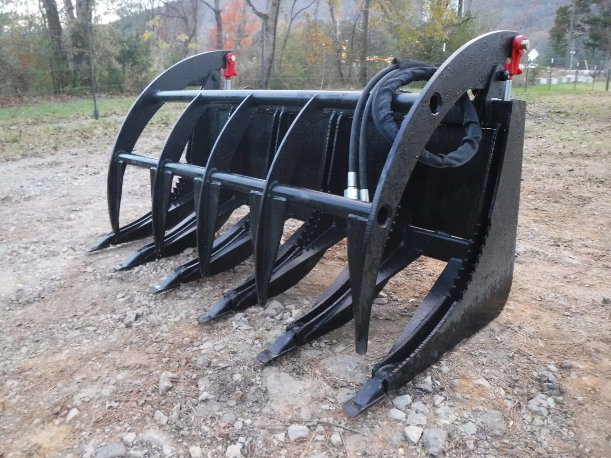

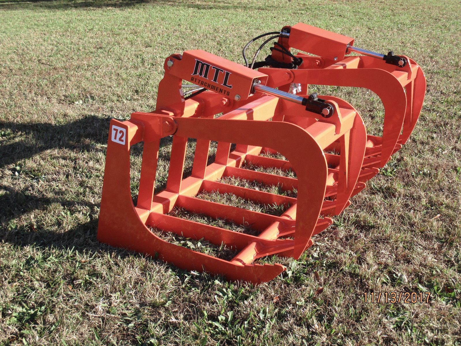

Really like the wicked grapple. Some grapples have lower tips parallel to the ground (like the green one) and some have the tips curled up (like the wicked). Is there any really advantage/disadvantage to either design?

JohnThomas agree with your points with grapple vs claw. Didn't even notice the Wicked was a claw(guess working 3rd shift doesn't help) I was trying comparing grapples designs. See pics
I might be going with the 60 MTL grapple like the picture you posted.
It is a lot heavier than the EA wicked. But it痴 really reasonably priced
   / What size root grapple for my 2850? #18
The black one is from skidsteerattachmentdepot the 60" is $1095 and weighs 550lbs If your buying it for your B2650 let me know how it works for you. My L3400 FEL has about the same capacity. I'm not sure how 500lbs will work, only leaves about 350Lbs of load. Anyone know if when they give FEL lifting specs if they include the bucket weight. I think my bucket is around 90lbs, but I can't find anything specific
