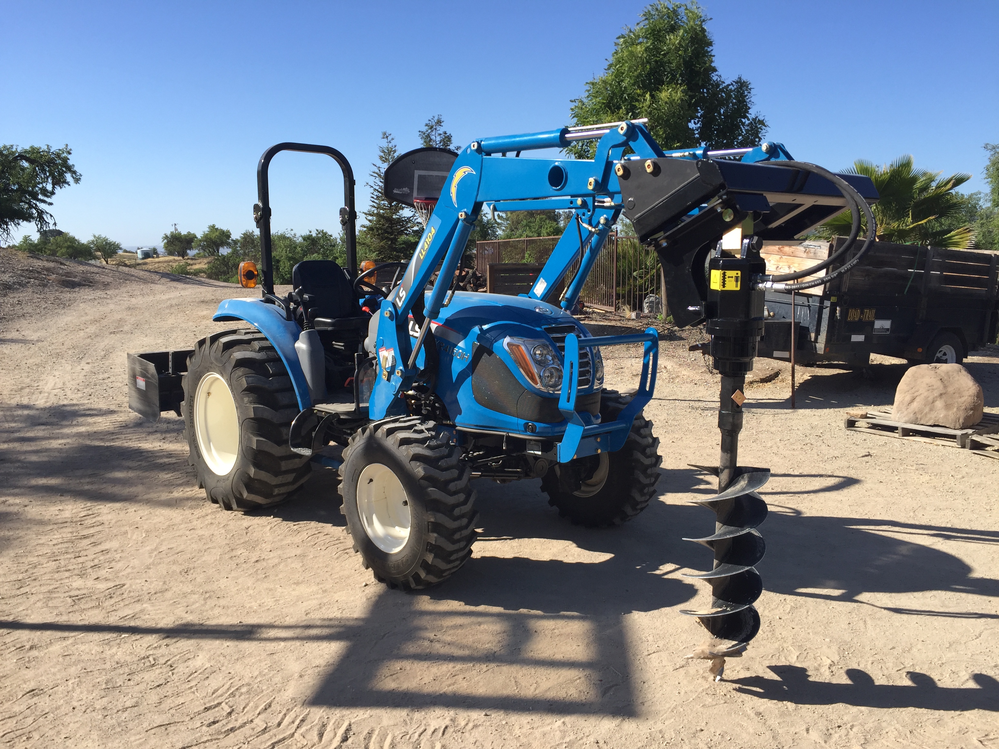

I'm having alot of fun with front hydraulics. I do need to build a land pland for my D.G. driveway tho, the box scrapper even with top-n-tilt isn't great for feathering out washboard.

Nice tractor,
My bet is you'll have lots of fun on it. I mean get lots of work done.:laughing:

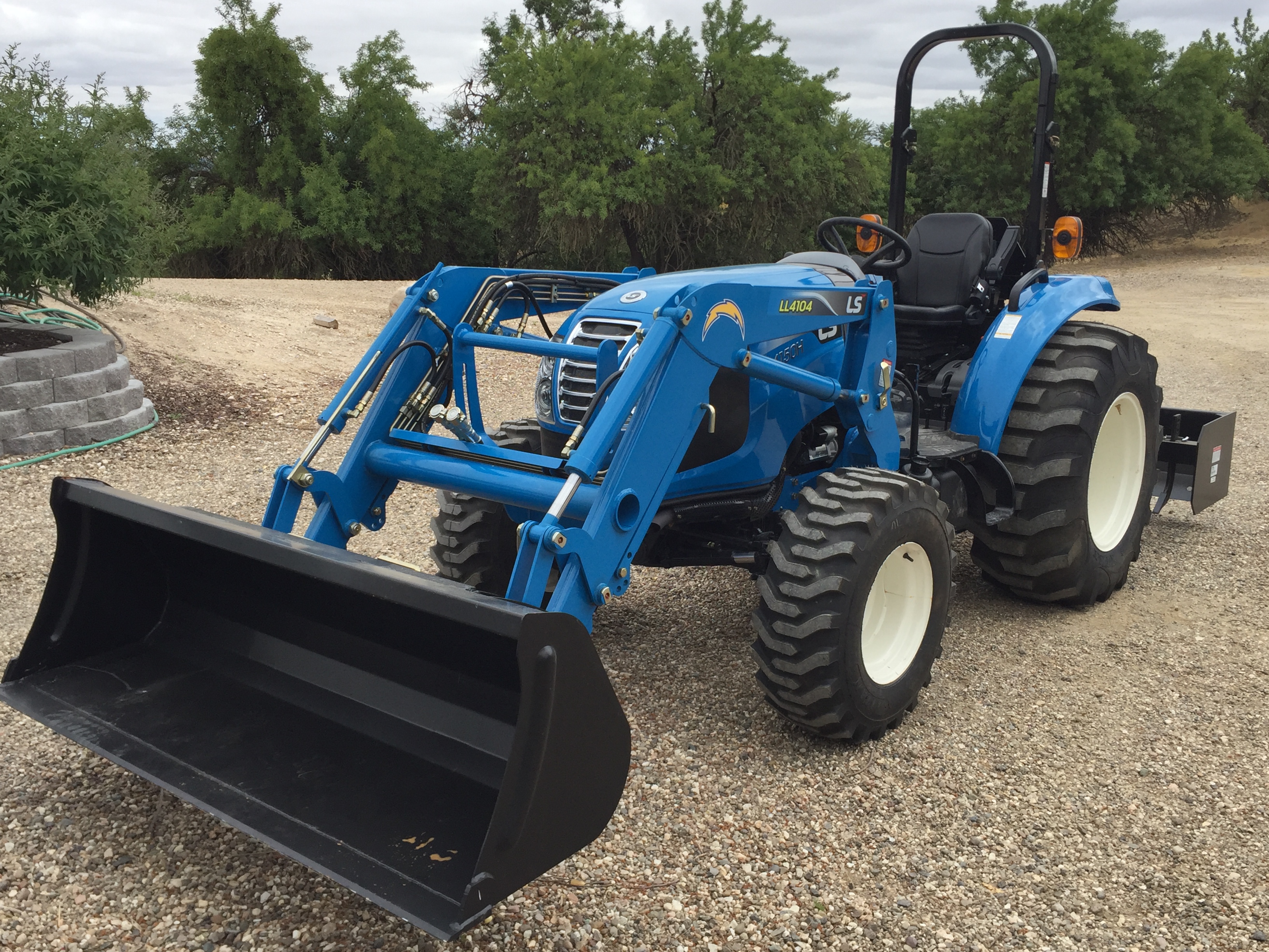

/ what size LS would be the best #16
Congrats, That's a nice Tractor. I'm sure you will be happy with it. Have fun!

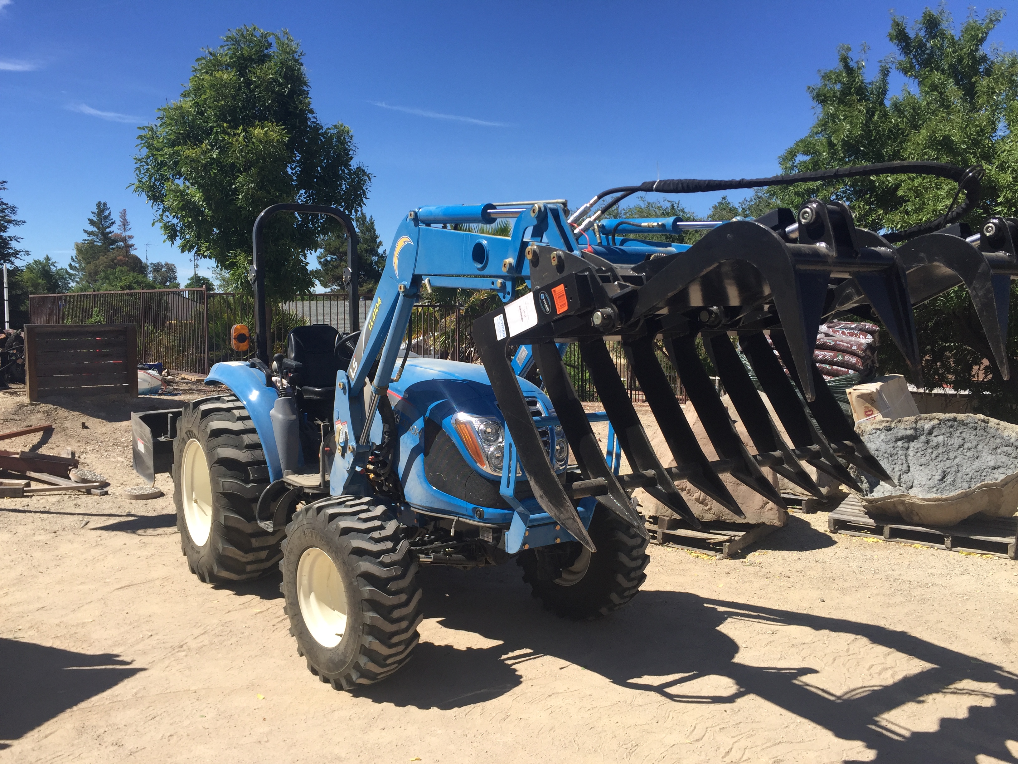

/ what size LS would be the best #18
That's a tough looking tractor. I like the large front tires. Congrats on the nice machine.
