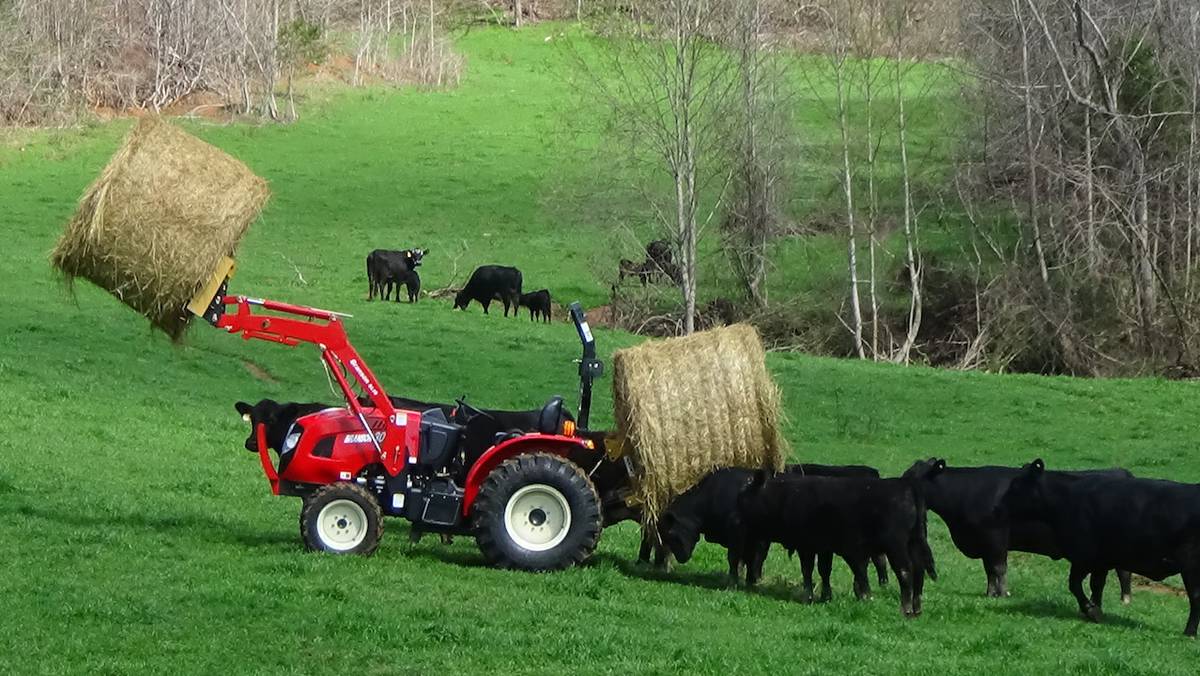

Apparently you only need a 30HP Branson.
/sarc
