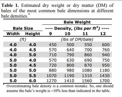

How heavy a bale?
I think if you are only worried about lifting 1,000 lbs all would do.
Stacking 2 high may be a stretch, are they on a spear or forks?
   / What size Kubota for round bales?
We've never weighed a bale but they're all dry fescue. The Ford has no trouble handling them with or without any ballast on the back but the Ford weighs 5000# +. I keep a 6' Bush Hog on the rear in the winter for ballast when feeding.
