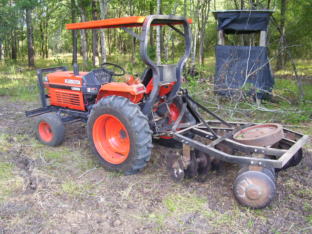

Here is my 5' light duty disc. The round thing is a heavy flywheel that came with it (used of course for $200). I use it in this gumbo junk for deer plots, in the sandy loam that's been worked before I don't need it.
Rob

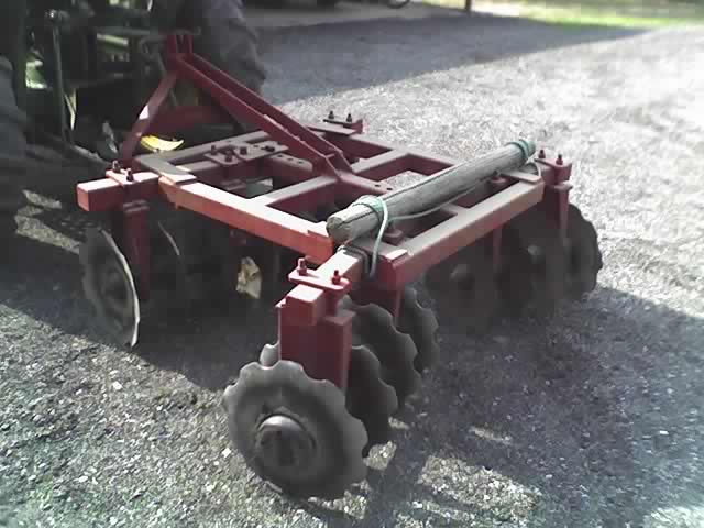

Picked up this 5.5 footer yesterday, (they didn't have any discs in whole number increments). It's made by ATLAS, adjustable blade pitch and ball bearings. I'm happy with it and the tractor did fine pulling it, both up the hill and down.
Couple of pics....

Sweet, looks like it's set pretty aggressive now, you can straighten them out and it'll pull even easier.
