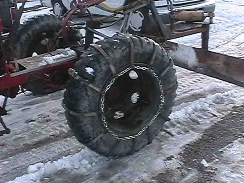

   / what size chain for guard?? #3
I found the chain I used for my tractors bar chains at Menards.3/16 and the links are about an inch long.$12.99 for twenty feet.If you cut the end of the link and use that end to weld it into place you would have zero loss.
