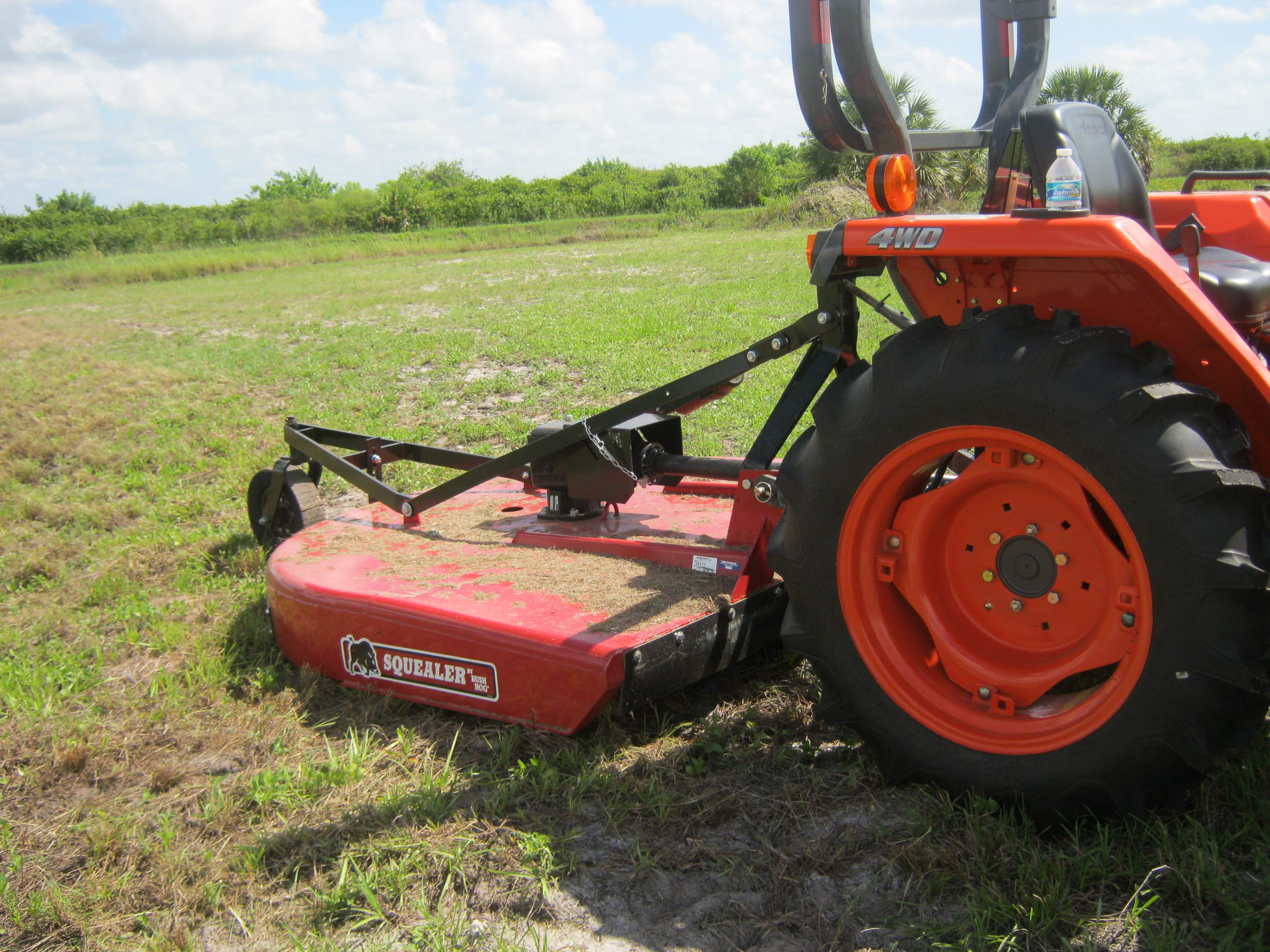

   / What size Bush Hog, 5' or 6'?! #58
   / What size Bush Hog, 5' or 6'?! #59
I have same predicament I need to replace rotary mower have a 5 ft. not as wide as tractor would like to go with 6 ft. but my problem tractor and 5 ft. mower barely fits on my 18 ft. trailer. I guess I could replace trailer with a 20 ft. one or just get a 5 ft. mower and learn to be happy anybody have any ideas?:cool2:
I'd definitely want a 6 foot cutter on a L4600!
