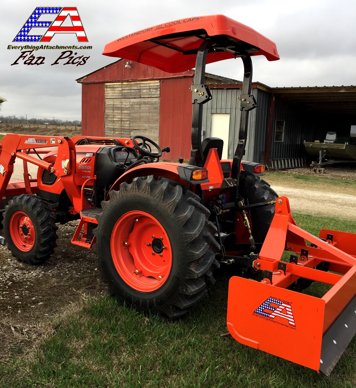

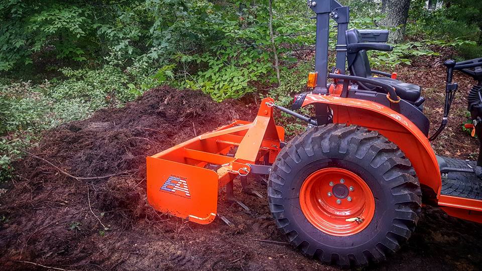

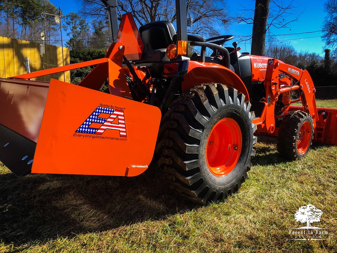

You always want a box blade at least as wide as your tractor or a little wider. How much wider(66" vs 72") really depends on how maneuverable you need it to be.
People tend to go narrow if they have tight areas to fit in.
People tend to go wide if they want to grade up next to something...trees/house/wall...without running the tractor right up next to it.
The Xtreme Duty Compact Box Blade is a nice fit for your tractor.
Our Xtreme Duty 30-70 is a step up in weight, so they're really popular with CK/DK owners!

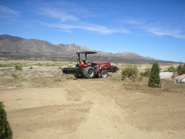

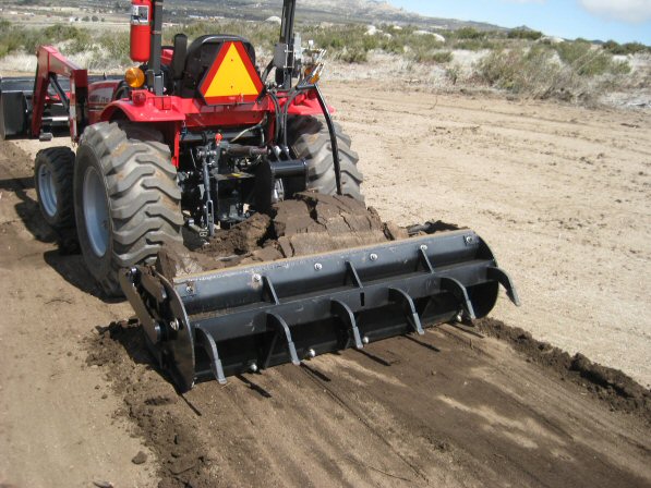

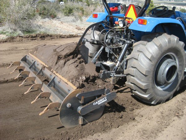

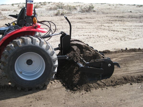

If you want to get the rippers engaged with a single pull of a bar, I would consider a 65"ROBB. I little heavier unit than most and a dream to work with. :thumbsup:
That looks very nice. I think it's Jeff who also posts pics of a similar style rollover. Every time I see pics of them makes me wish I had at least checked into that type before getting a typical one.
They really do work well. I opted for them over the hydraulic units. Each type, like everything have their positive and negative aspects.

/ What size box blade for ck3510 #10
That pic with the blue tractor - wow that's cutting nicely! Mine won't do that even weighted down @ 1,000 lbs total. Of course could me my high rock content & red clay.... But still, a cut that deep mine's either gonna want to skim or try to bury itself cutting down as it goes. No in between on somewhat moist soil like that for me.
Are those rippers fixed or can you still adjust each ones individual height on that kind?

/ What size box blade for ck3510 #11

A lot depends on how it's ballasted. My red tractor is 32hp, HST and 5000lbs. It has zero issues with a 65" 800lb ROBB.
The rippers, mine anyway are set at 10". You want-need a different depth, you adjust with the hitch.
