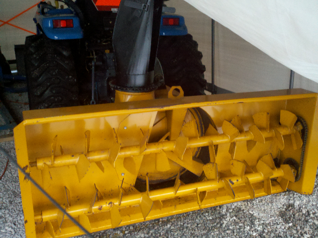

Have a lead on a Lorenz 530. Anyone have any opinions on this blower? Looks like a 3 blade fan, but other than that looks great
   / What size blower can my tractor handle #18

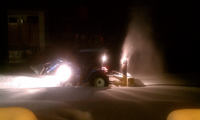

I run a Lorenz 630 on my TC25D with a Hydro trans. 20.3 pto hp. Never an issue with the blower. You can find them online lorenzmfg.com. I have worked with them for a copy of the manual and some spare parts. Most parts they use are available at industrial supplies. Mine is also a 3 blade fan.
