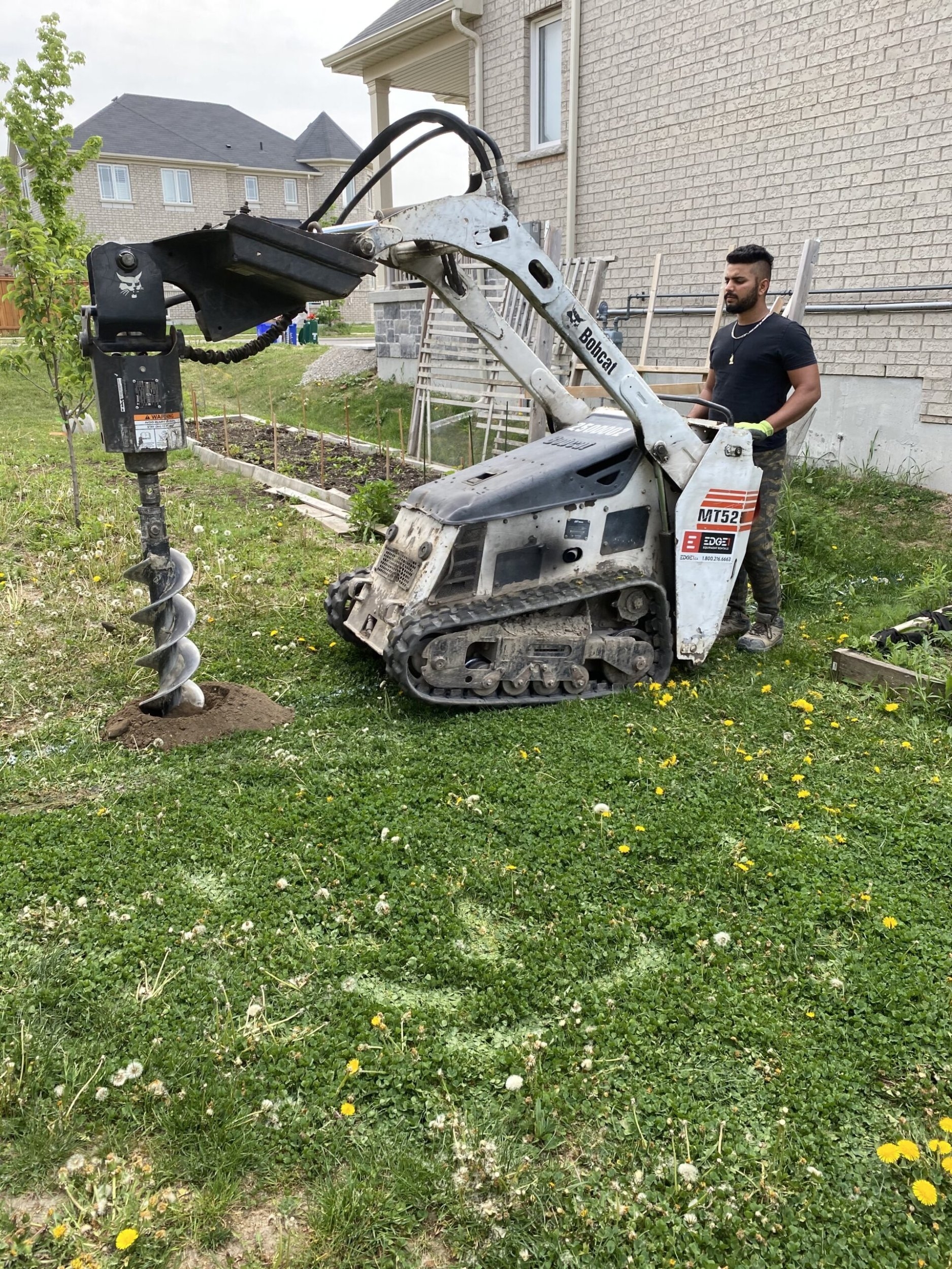

If anyone lives in Ontario or near or needs an affordable Post Hole Digging service you can contact MSG Post Hole they are very good with their services they just recently finished my work before the estimated time.
I am satisfied just wanted to appreciate their work.
They have some good machines.
