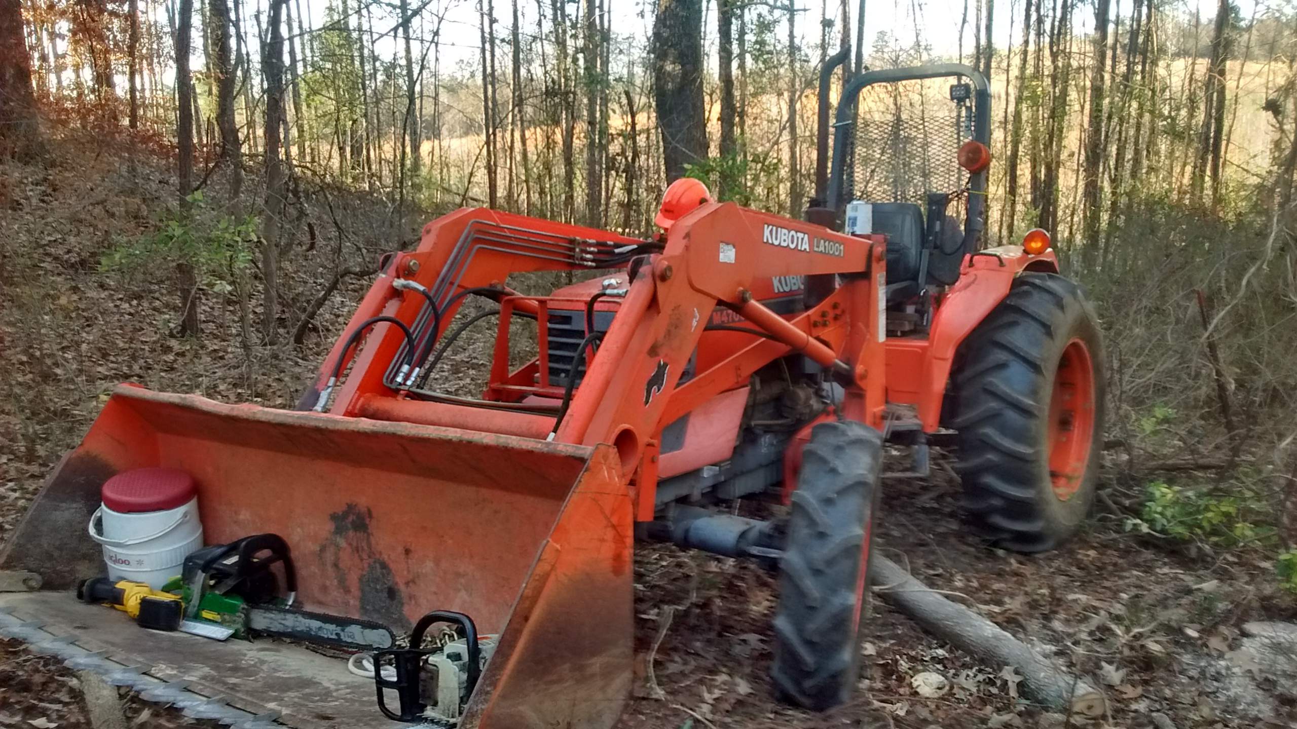

For example I needed to carry 1,000lbs on the FEL, ended up getting a Kubota M4700 (50HP) for $11,500. IMG_20151207_150524186_HDR.jpg

Newbury - The terrain in the picture you posted of your M4700 looks like it could be taken on my property in western WI!
