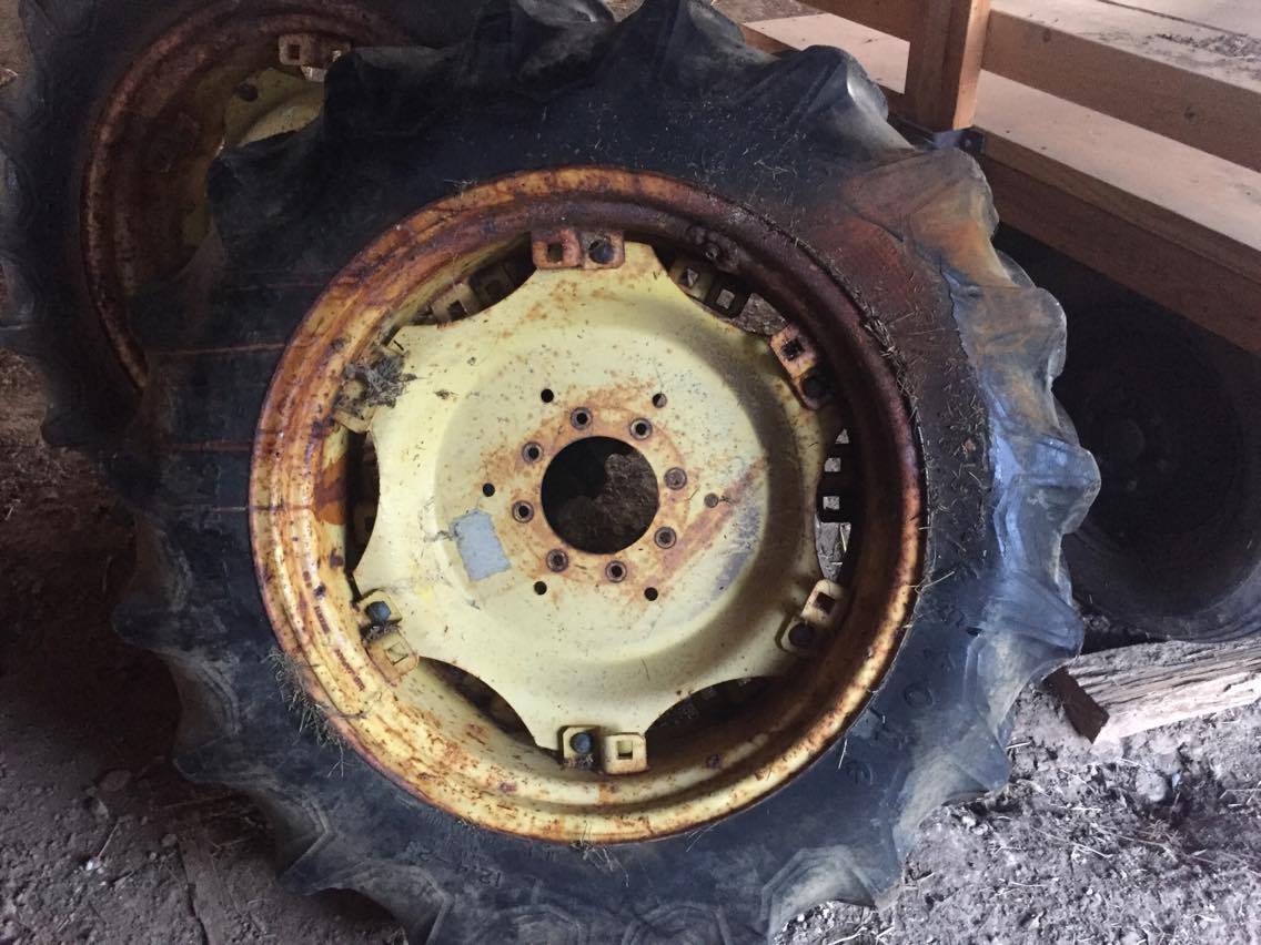

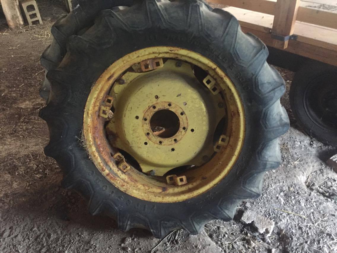

I picked up an 85 JD 950. The wheels and rims on it are the wrong size and one is larger than the other. It also came with the original rims and tires, one is destroyed and both rims are riddled with rust. Looks like the only salvageable portion is the inner portion of them.
two questions: first, are there other rims that the inner part of the JD rim will fit and two, is there any problem keeping the larger rims/tires (as long as they're both the same size)?

You need to maintain Front/Rear ratios for 4WD.
   / What rims will fit JD 950? #3
Will get costly but to save your clutch, axle bearings, etc, I would get the oem sizes. Selling the goofballs will help offset the price.

So I have been searching the internet and actually went to a couple places in southeast Missouri looking for wheels/tires. I'm told this size is extremely hard to find used so I am looking for new. I am in need of two 12.4x28 tires and the correct sized outer portion of the rims. An Ebay seller, Tucker Tire out of TN, has 2 new, 8 ply tires on 28 inch, 6 loop rims. The only thing I see different is that the loops are a different shape than those of the original rims. Has anyone had any experience with these or does anyone know if they will fit the inner parts to my rims?
Here are my current rims/tires. They are pretty well done for and the outer rims are rusted through.

I think a Yanmar 336 has similar wheels, need to confirm however
   / What rims will fit JD 950? #9
Part numbers INFO RECEIVED FROM jOHN DEERE Dealership.....CH11078 RIM FOR USE WITH 12.4-28 TIRE.....CH12164 RIM FOR USE WITH 13.6-28 TURF TIRE NLA (no longer available) .......CH11077 WHEEL (center disk?) 28"
