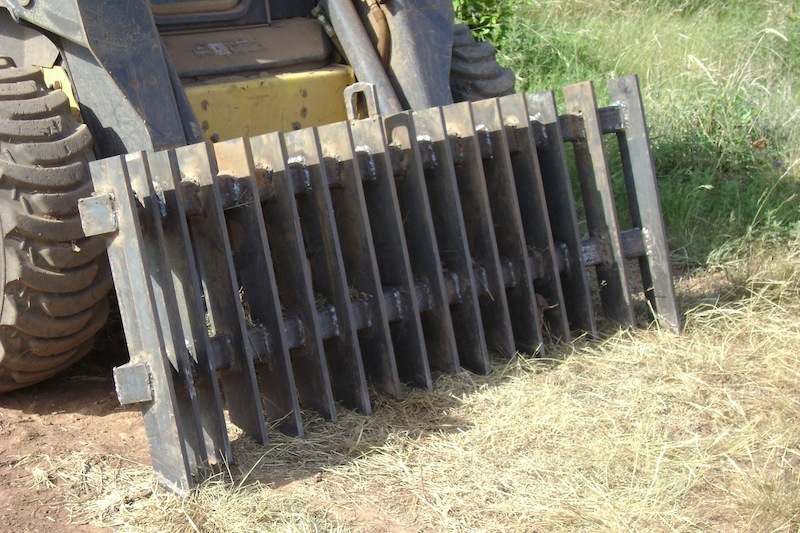

UPDATE: Finally finished grubbing the mesquite and thistle from the 33 acres last Friday afternoon. It took 70 hours. That is an average of just over 2 hours per acre.
Started Raking today with the new rake I had built last week. I will get pictures tomorrow. It is much faster than dragging the rock bucket backwards:)

   / What price for grubbing mesquite? #25
That's impressive speed, good job.
New rake, I assume, is more like a root rake for a loader then a grapple?
#26
Here is the rake that we built for this project. It seems to work pretty well
Tim
