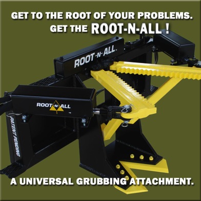

Anybody used a Root N All Grubber? Or even seen one?
Looks like it might be a step up from what I am using.
