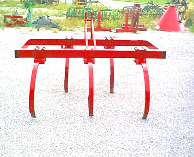

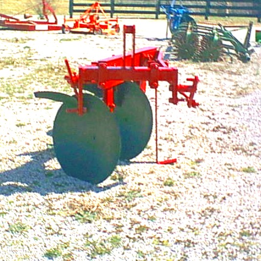

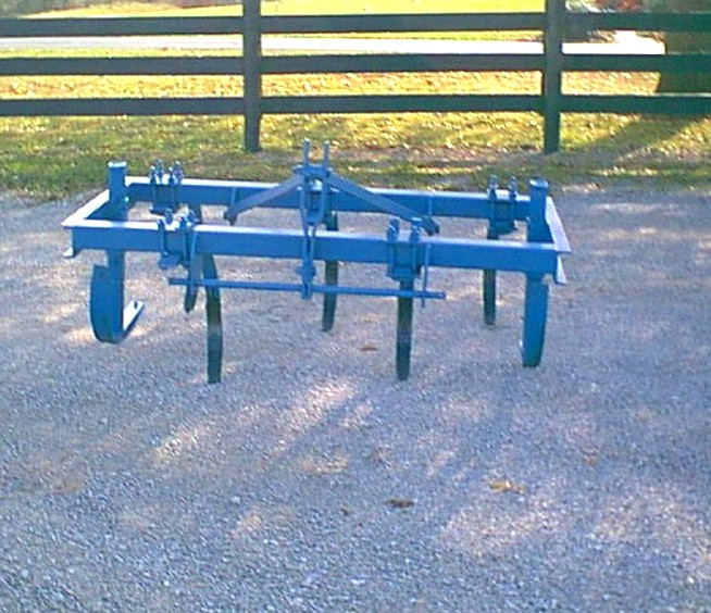

We have the 3 point chisels and a disc plow would also be good in roots and rocks. Ken Sweet
