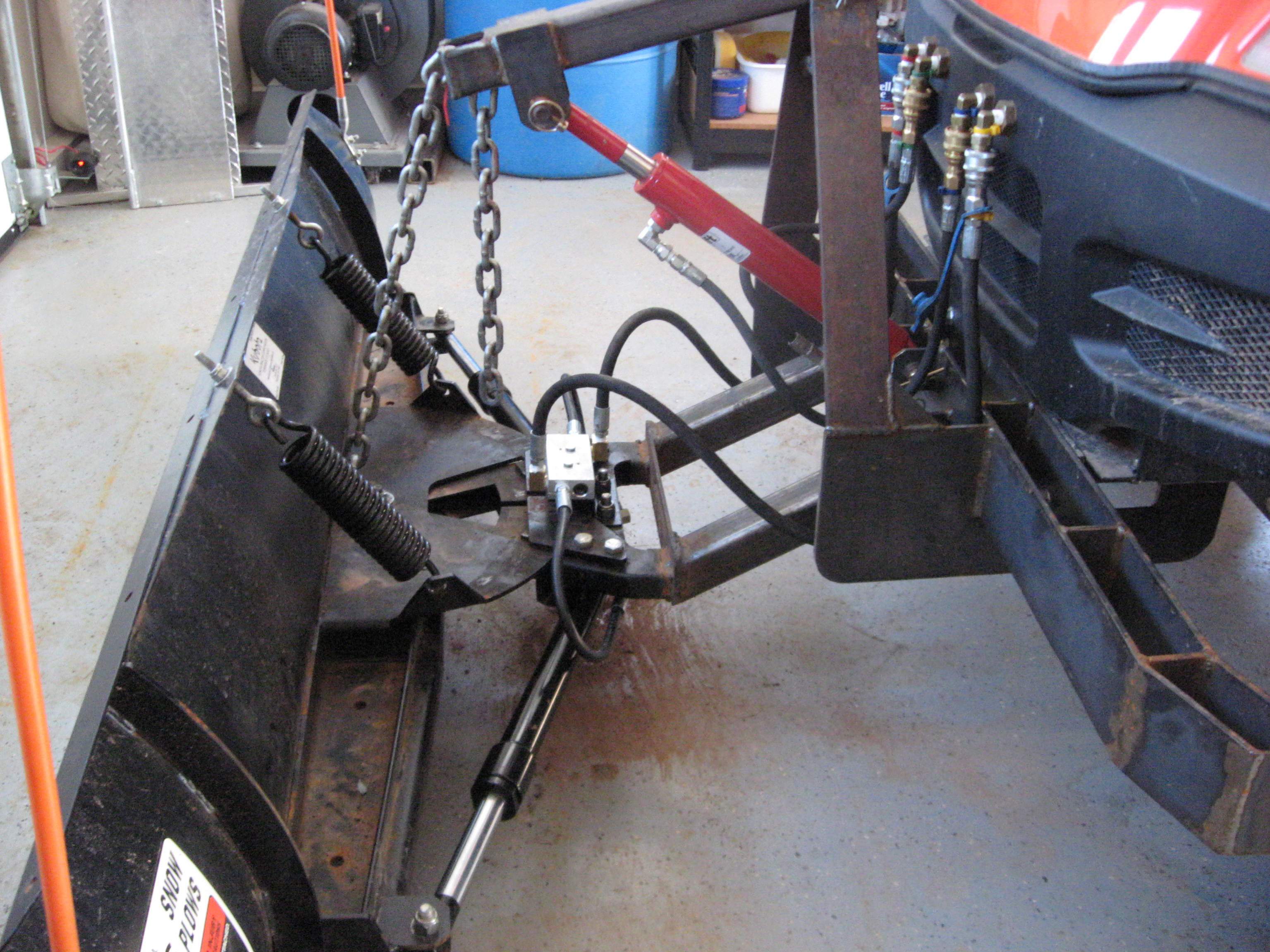

   / What plow do you recomend #4
Well you did say you were cheap!
Look for anything used, cheap, in about a 4-5 foot wide range. Should be minimum 6-12" wider than the ATV. Wider and the blade shoves the machine sideways when angled because an atv is light.
Get your local good buddy, welder, to fab some mounts to the front. Attach winch, start plowing.
Key point, the blade pivots on an a-arm that then mounts to two pivots on your ATV, when fabricating or modifying the a-arm mount to fit your ATV be sure the pivot is level with the ground so the blade pivots left/right and remains flat on the ground. If that center pivot bolt is not perpendicular to the ground when plowing, the leading or trailing edge of the blade will be off the ground when you angle the blade. Not what you want.
I change my curtis plow mount and learned the hard way.
A good welder and you can attach any used plow to anything.
Angle adjustment is up to you. Usually manual for Cheap ATV drivers :laughing::laughing::laughing:.
