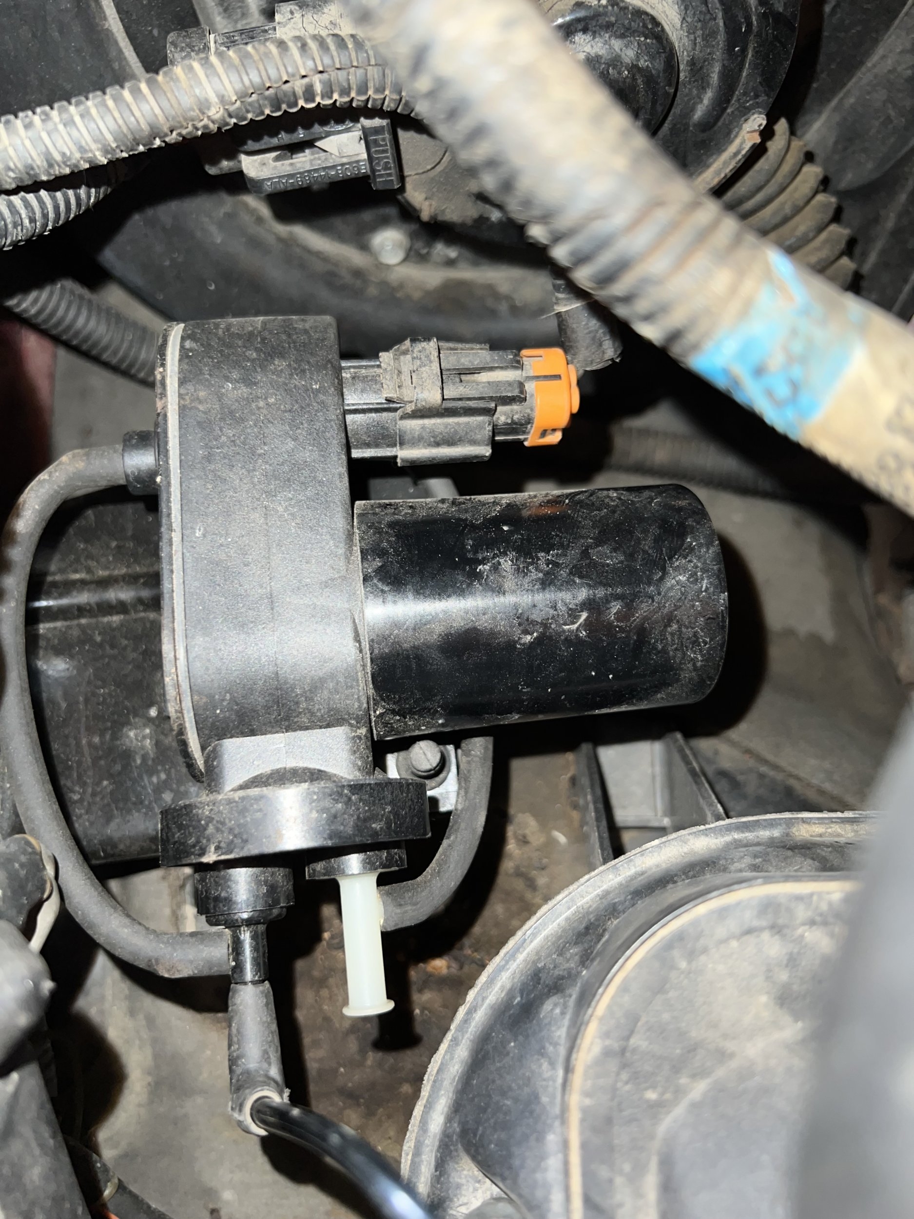

It's mounted on the inside of the passenger side front fender, about half way front to back of the engine compartment. Looks like it lost some tubing.

Looks like the vacuum pump for front hubs, etc

I had a 2k 7.3, don't remember that (I had manual hubs)

It’s a vacuum pump that works the heat/air conditioning controls and if your truck has power locking hubs it does that.
   / What part is this? (1999 F250 7.3 Diesel) #7
nothing missing, that's how it looks, only hose on the white piece is the one coming off the side of it
