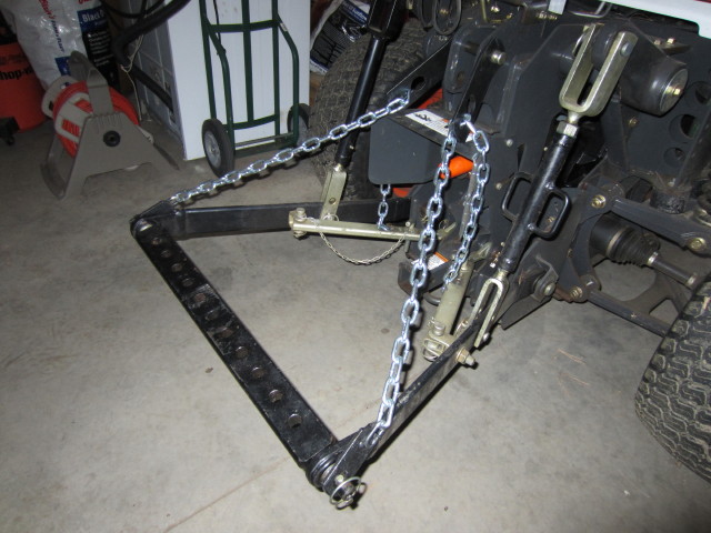

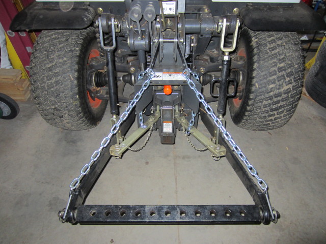

The 5610 has a real nice 3pt lift control lever and a height indicator out the rear window but no stop to set for height. When I'm using the 3pt rotary cutter and I get to the end of a row, I like to be able to raise the cutter, swing the turn, then drop the cutter without having to look backwards at the indicator. Tractors have a stop you can set on the 3pt lever, but not the Toolcat. So, I ordered a set of Mower Deck Height Stabilizer chains/brackets that I have seen used on old tractors. Here is a picture of them set up with just a draw bar so you can see how they look. The upper link would mount using the same pin that is used for the chain brackets.

Will the chain or upper bracket hit your PTO shield? Looks close in the photo. On mine, the chain/bracket definitely rests on the PTO shield when the 3 point hitch is lowered enough.
   / What? No position control stop on 5610 3pt
I'm not sure...I'll have to take a close look next time I use them. The main chain and bracket are slightly away from the shield when in use. I did zip-tie the loose ends to the other leg of the chain as they lay on the shield.

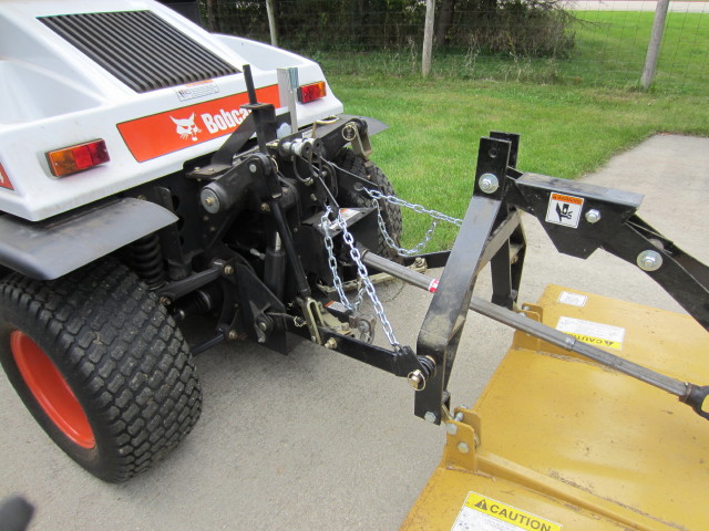

I mowed again and if you use the upper holes, the chains are not against the pto guard.

Tried it out, and yup, works like a charm. Thanx ruffdog.
