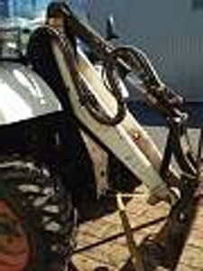

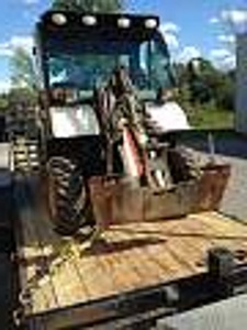

ulmn
Member
Apr 7, 2014
30
ottawa
5600

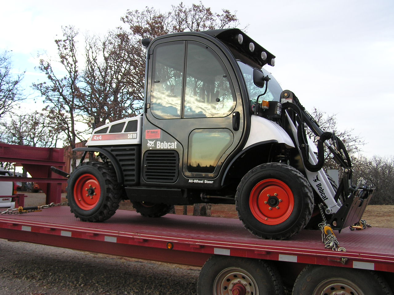

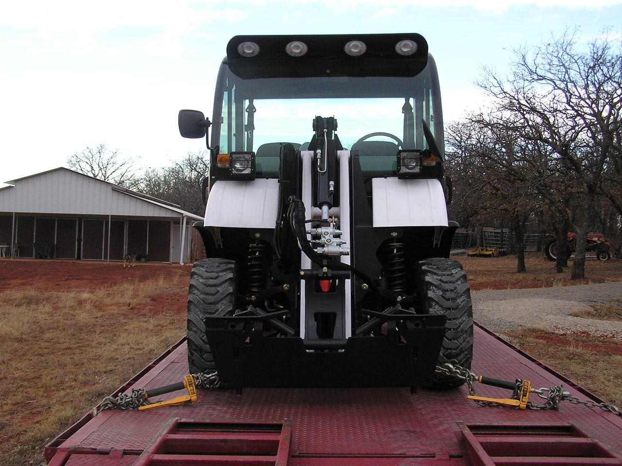

It's a 5600
Has independent suspension in each corner
High flow
2 speed
Double lifting arms
Air conditioning

I broke the front windshield out of it at the cottage and they need to know the first 3 digits of the serial number to order a new windshield.
And I'm not going back to the cottage till December 1st

The Boom would indicate that it is a C class or newer but its impossible to tell from your photos. Do you or a previous owner have an invoice from the dealer which will typically include the serial number? If you know the previous owners name I would suspect the dealer can find it in their system. The last windshield we lost in a Toolcat had to be air freighted from Chicago and was not cheap. If you have a key-less entry call the dealer and provide the code. If unchanged the code may provide you the answer...

It's at my cottage, and won't be heading back up till December
I can get the serial number then, but I want to get it ordered now.
What other pics or details would you need to tell me what model it is?

The front boom design did start with the C-series however Independent Suspension stated with the D-series. With Independent suspension and a Kubota engine it is either a D or F series. First 4 digits of serial denote the series. D starts with A0W1 and F is A94Y. Both of these use same part number windshield 7116155.
The G-series (newest model) also takes this same windshield.

Perfect, so your sure it will be that windshield? As it does have independent suspension.

How can I tell if it's a d or f series?
   / What model of toolcat do I have? #9
Your pictures are too small to see much detail.
I enlarged and rotated them:
   / What model of toolcat do I have? #10
5610's are just plain cool. I love the 3 point.
