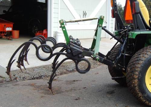

There are a few tool bars, usually sold with disc hillers or chisel plow cultivators bolted on. One source is this one (this will be the disc hillers, but go to the home site to see the bars): http://www.buctraco.com/disks.htm. Agri Supply also has them. Their disc hillers (without the bar) are half the price of the Ohio outfit or an outfit my JD dealer had for them. The Agri Supply disc hillers are made in India. All the current tool bars are carried "square". Mine is carried in diamond formation, with one angle down. Makes it more difficult to come up with clamps for the diamond, but they may hold better.
I got my tool bar with 7 chisel plows from a friend who was no longer using it. He works in a machine shop and converted it to 3 pt using a design of mine and materials I bought at TSC. He also designed and built the clamps for the shanks of the disc hillers. He used the "soil ripper" (with the chisel plows) on his old JD M, which is an 18 hp gas 2 cylinder vertical engined JD. My 4010 pulls both the 7 chisel plows and 2 16" disc hillers set at 45 degree angles fine. It would NOT be able to pull the 2 16" discs set at the same 45 degree angle, because they'd kick it sideways. The tractor is too light, only 1400 #.
The raised rows are essentially the same height, etc. as what I got with my Gravely rotary plow. However, they're much more uniform. It got 20 rows where I had only 14 with the Gravely plow.

The queer thing about the commercial disc hillers is they say a minimum of about 30-35 hp is needed. I had no trouble pulling the 2 16" disc hillers set at 45 degree opposed angles with my JD 4010.
You can buy one of the "cultivators" with about a half dozen chisle plows bolted to a 2x2 or so bar. Just buy a couple disc hillers and have a machine shop or welding shop fashion some clamps for them. The Ohio web site has clamps. I got no reply from them when I asked what they looked like. The pictures didn't show up on their web site. This is the site for the disc hillers http://www.buctraco.com/disks.htm where they have the clamps, too. The disc hillers at Agri Supply are about half the price of theirs, but no clamps. My friend made mine for me out of scrap metal.
