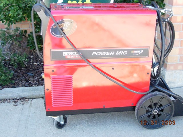

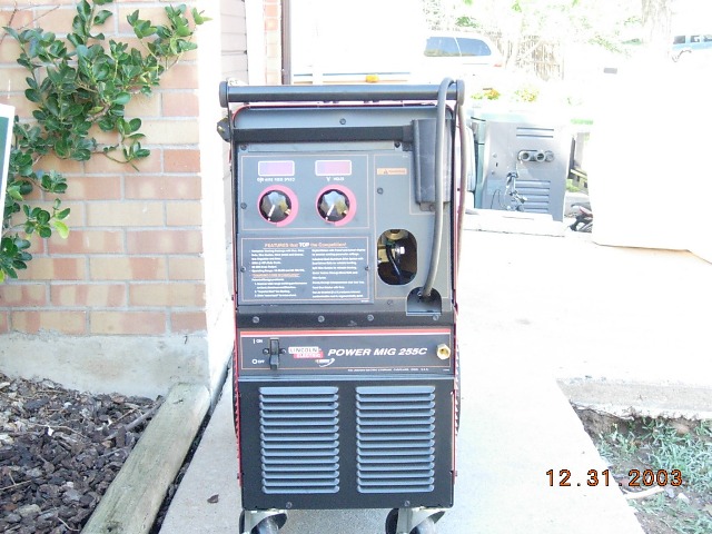

This is what I just picked up.
I got a pretty desent deal. 2 80cf 75/25 bottles, 44lb .035 spool of wire a Miller elite autoshade all for 2800 inc tax
