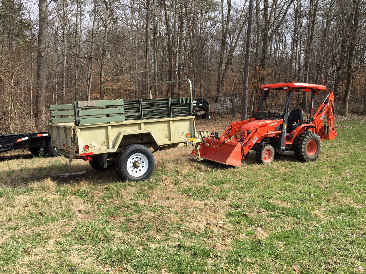

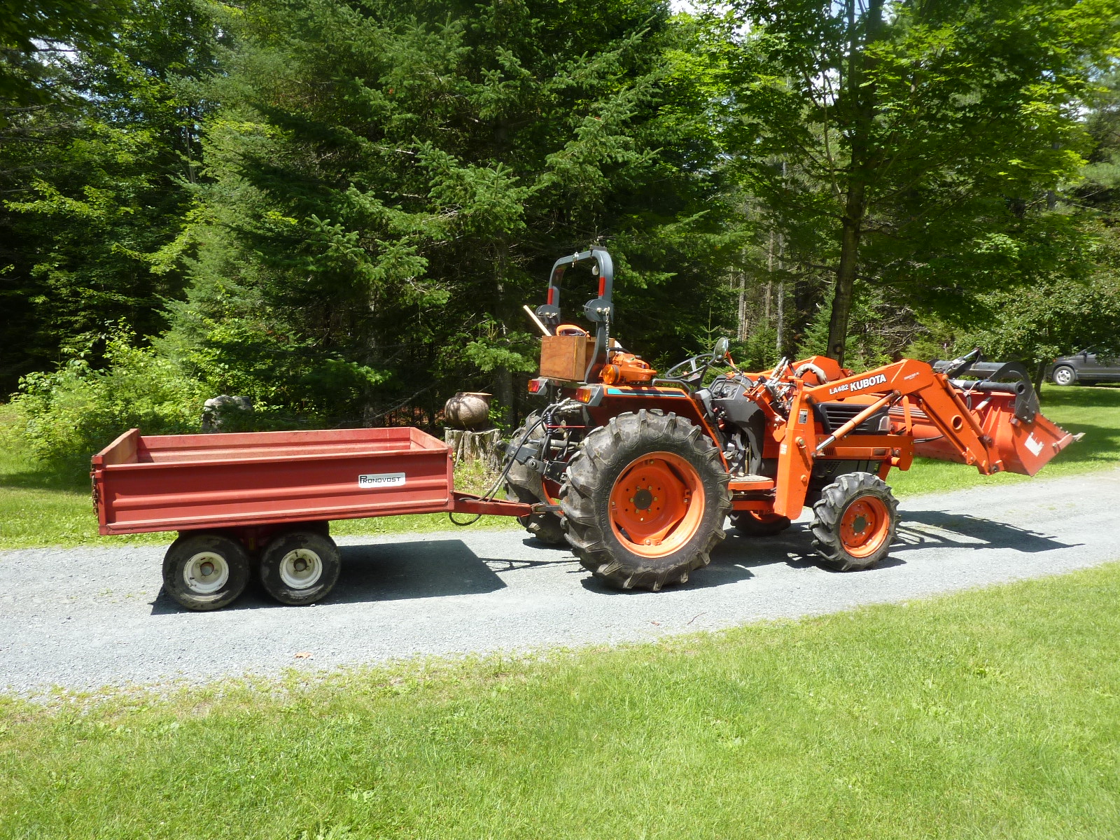

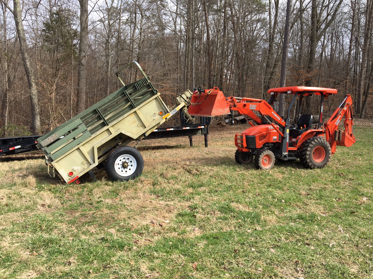

Army trailer has been a real gem. $500. Can use it behind the truck on the road to get mulch from the sawmill. Use it on the farm with the tractor to position and place mulch and compost easily. Carry firewood. Has surge brakes that can be locked out with pin if needed. Has adjustable manual brakes for each wheel which helps on hilly ground. Has a dumping feature I don’t use. Pintle hitch is fast, strong and use the FEL to dump. Hitch receiver on bucket. Wide angle rear view mirror it handy. Easy to hitch/unhitch with brakes and then use the loader to load and hitch again. One of many options to use. Army strong. 26hp tractor.
   / What is Your Off Road -Ranch - Farm Utility Trailer #82
I like your dump mechanism Smokey. Simple and clever.

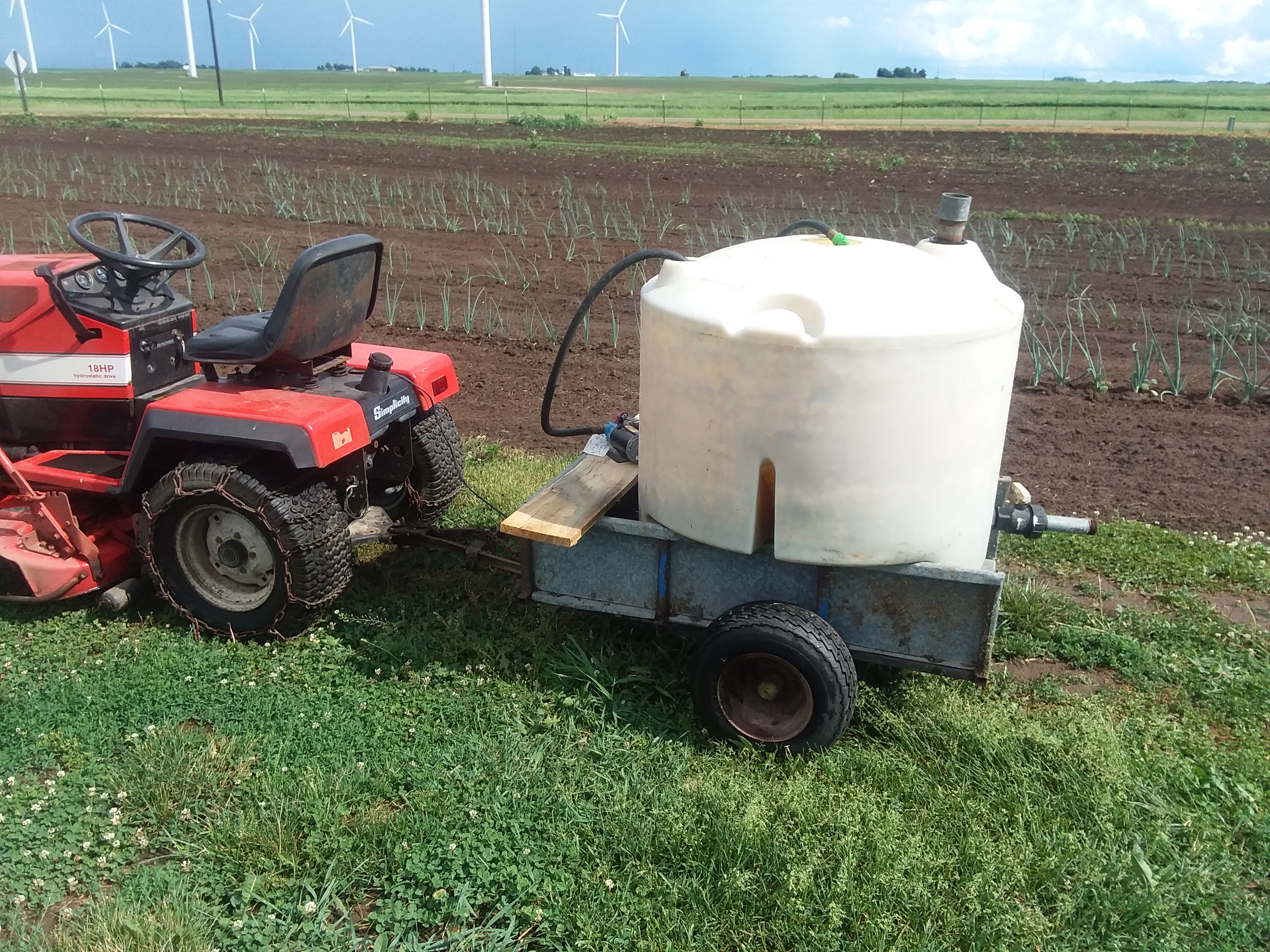

Make one! Here is one of mine--the smaller one. I fill the water tank to run-over full,(110 gallons) and go to the garden. Size yours to what you need.
This was made from heavy tin and 1" square tubing. axle was from a wrecked 1,500 pound trailer.
