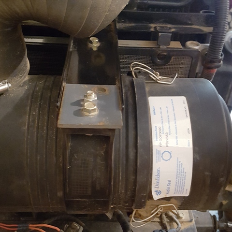

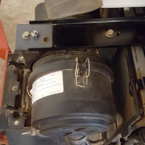

I hate the radiator screen arrangement. You have to have the loader up. Screens come out only from one side. Rear-most screen (actual radiator screen) goes on tabs/hooks and, on mine anyway, you have to unhook from one side first else the other side you cannot get off (and then you have to remember the sequence in reverse to put it back in): requires running around BOTH sides of the tractor to deal with just this stupid screen.
[snip]
Yep, same on the other NX models. Have to unhook both screens from one side, then walk around to the other.
Also, the air cleaner unit is mounted closer than necessary to the screens, making it harder to pull the first screen out. A minor nuisance, yes, but keeping the screens clean is important, and this doesn't encourage it. I gained more clearance by moving the unit forward with a bracket extension cut from scrap steel plate. See pics. (Thanks go to EricTheOracle for the tip. :salute: )

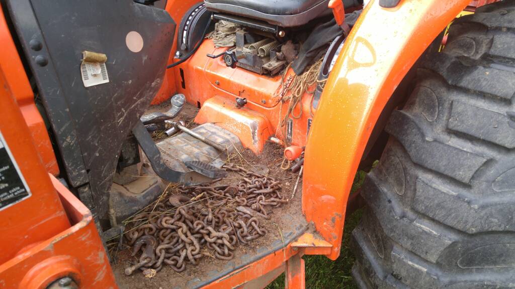

After only 20 hrs. on our Kioti CK, I only have 2 gripes so far:
1) The key placement on the side of the steering column is a PITA. I manage to bang my knee on the key about once out of every 5 times I climb on/off.
2) No step on the right side. Plenty of open space to mount up from either side - give me the step on both sides!
BTW - for all those that think the cup holders are too big, I had that problem on a boat I used to own. These things work great (but wait until there's a sale...).
