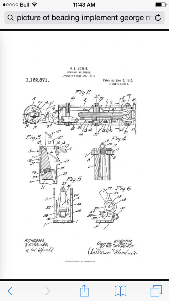

I enlarged the picture to 400%. Lots more details. The right round piece (shaft) is adjustable in a slot. You can just see the slot to the right. The left round piece with the punch in it has worn a circular divot in the hammer head. The left round piece also has notches around the outside and I believe that there would be an advancing mechanism to turn that left drum every time the lever is pushed. The "punch" does not have a sharp point and it has a rounded edge on the lip sticking out. I'm starting to think that it is a tool to round over the edge of a hollow brass or similar metal bushing to rivet it into a hole.
   / What is this
#17
One of my friends, friends saw more pictures and figured it out. If you Google "George E Morris beading implement" you can read all about it.
1888642_10155745592470515_8168255158918003094_n.jpg11011787_10155745592160515_895067894277213187_n.jpg
   / What is this #19
So it's for beading boiler flues if I understand correctly. Interesting stuff! Thanks for posting.
