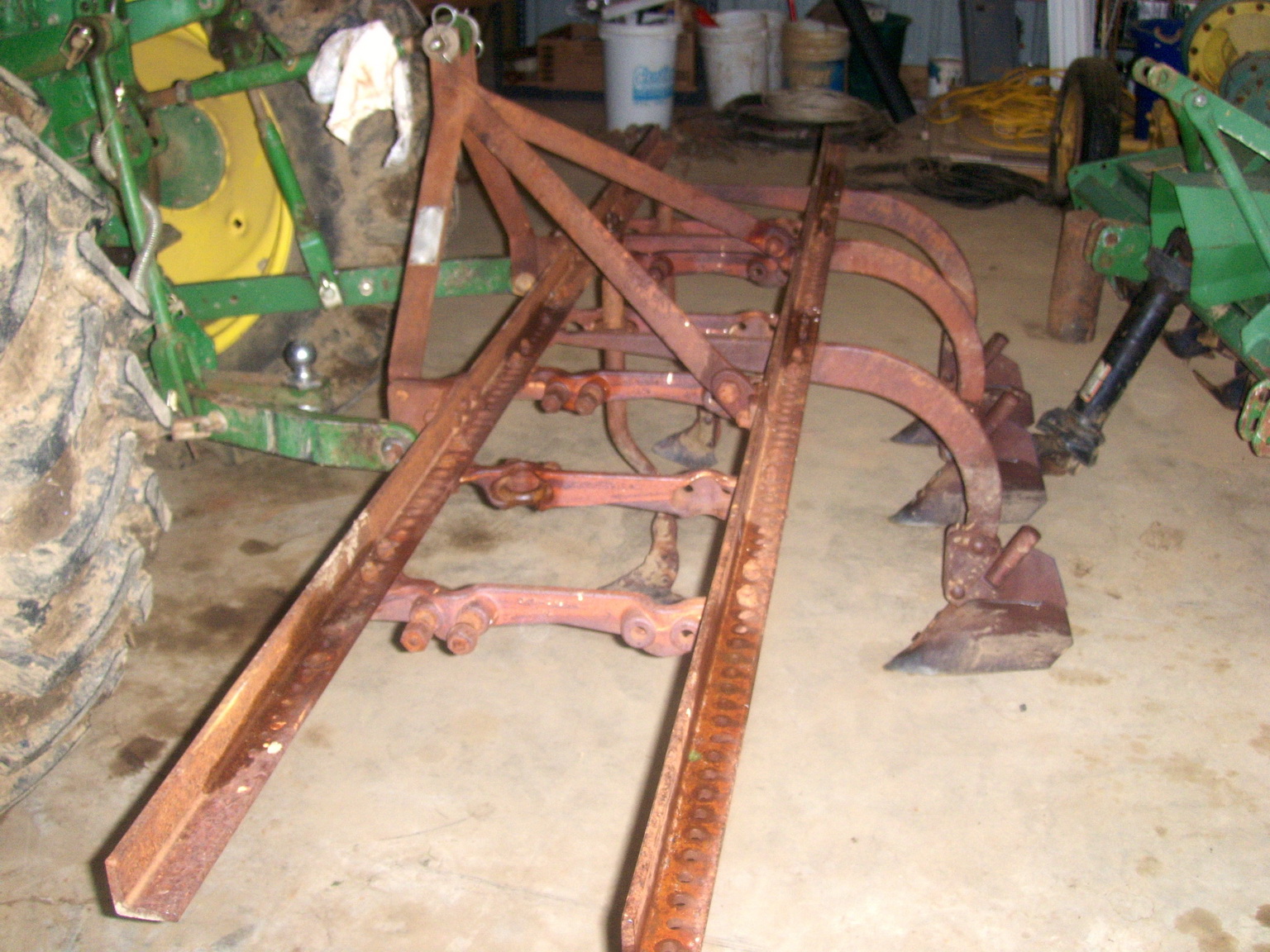

Welcome to the forum. How old is old? :D
Pic on that site is too small to see much detail.
Looks to be a tool bar with all but a few of the "tools" removed.
Quite a variety of different tools could be bolted and positioned on the tool bar, such as spring tooth diggers, sweeps for cultivating, tines for raking gravel/dirt.
If a better pic was available to post, then more may be determined.

I have and old Ferguson plow
Type TKO-20 No. 1065
Anyone know about this?
Here's a link with pics..
Yesterday's Tractors - Help Identify
Tx for any comments.
Looks like what we call a Field Cultivator. Here is a picture of a new 1 that is made here in Kentucky. Ferguson did make these in the fifties. Ken Sweet

Here's a better pic.

Thanks for the better pic.
Any more questions? Or did you get it answered?
   / What is this? #7
With those shovels and spacing it looks like some kinda hiller or potato plow....no? With those forging or castings it likely is a good brand for its day...like Dearborn or Massey or ?? :confused:

The "tag" or metal plate says:
Type TKO-20
No. 1065
   / What is this?
#9
I got this response also:
# JD Seller wrote on Friday, April 09, 2010 (PDT):
It is a rear mounted cultivator.
Someone has taken off most of the shovels,
and put the few furrow plow ones on it.
   / What is this? #10
Those castings that hold the shanks are either Ferguson or Dearborn. I have some here on the lot. Ken Sweet
