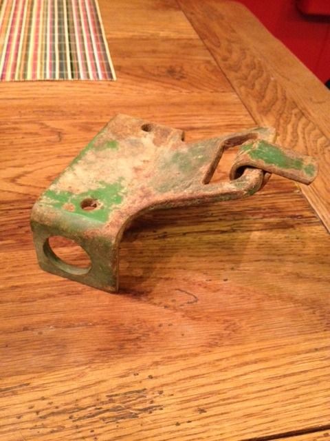

What part of the tractor is this? I think it was on a 72 deere. Thanks
/ What is this Tractor Part? #2
Looks similar,to what's on my 2155 that holds the center three point hitch top link when not in use.
/ What is this Tractor Part? #3
I agree with fieldman, it's the top link holder.
/ What is this Tractor Part? #4

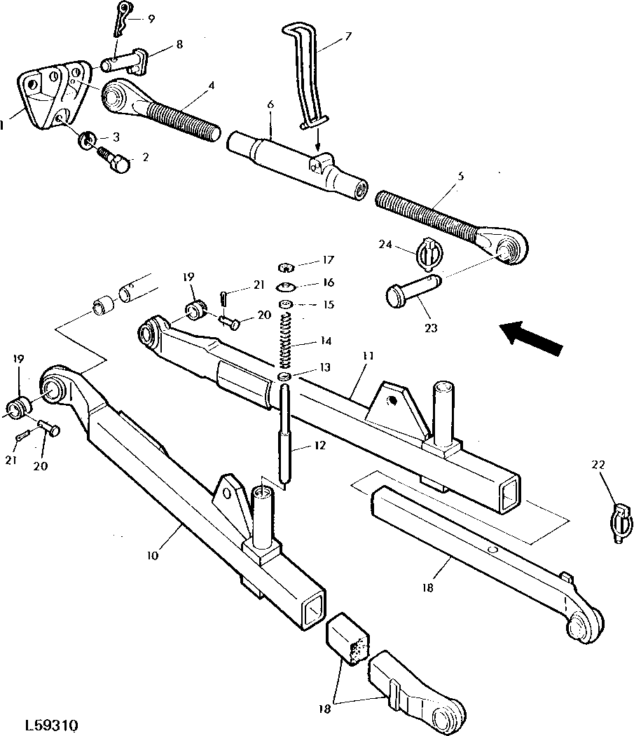

Ditto to what others stated as part is for a JD utility tractor. Parts key #7 slide in slot and tongue held center link up when not in use. Part would need to be flipped over.

/ What is this Tractor Part? #6
I have that exact same part on my JD 1020 But I don't have the correct top link so really don't know how it works. It does't look like it would work with the top link pictured
/ What is this Tractor Part? #7
Part in photo needs to be flipped over on tractor for center link handle to be inserted and held correctly

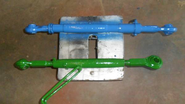

Just saw this on DFW CL. for $125

/ What is this Tractor Part? #10
Good pics. It looks like two different types of top links
Admittedly I am dense when it comes to figuring out how some things come together and work. But to me I can't figure out how the green one works with the part shown. Now I can't see all the blue one, it might work. Like I said dense unless I see the whole thing together.
/ What is this Tractor Part? #11
Top BLUE one is a FORD,bottom Green on is JD. I just happen to see that photo and posted it. I guess I should have photo shopped(chopped) the photo in 1/2.
/ What is this Tractor Part? #12
The green one may work with the part pictured. I just have a hard time visualizing it
I'll eventually see one all together, then I think I may try to find one for my tractor. I'm using a generic one now and holding it up with a bungee strap when not in use. It works
/ What is this Tractor Part? #13
If you look at part #7 where the top of the part is bent sharp to the left, you will take that and insert it down inside the part you displayed. On the part then in your pic you will flip the swivel part so that it holds part7 in the holder. I hope that makes since.
/ What is this Tractor Part? #14
Yes that makes sense. Thanks for the explanation
/ What is this Tractor Part? #15
Yep as fieldman12 stated the green one will fit your bracket if it's pinned to tractor with the correct end utilized.
