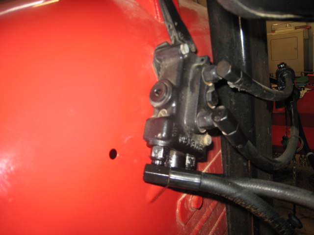

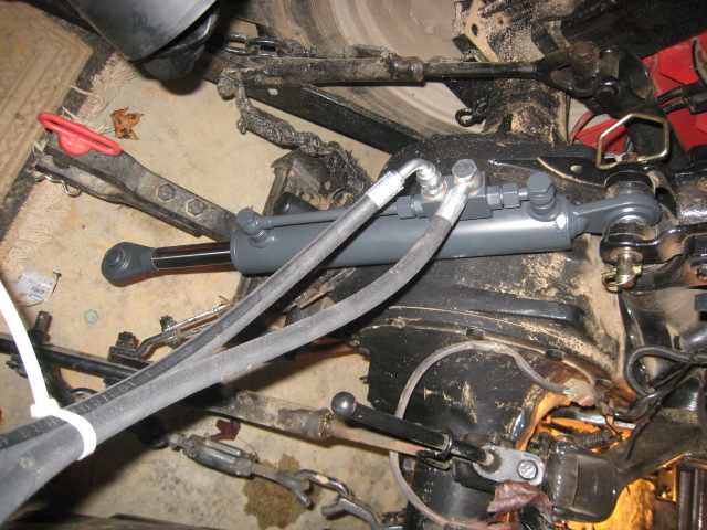

The TS300 has been overhauled. Works fine now. The hydraulic top link (with check valves) has been installed. Cylinder extends only...does not retract. Do I need a different control valve?

Wonder if your valve is made for a single acting cylinder. Something designed to be powered only one way and gravity return? Kinda like your 3ph
   / What is this thing? How does it work? #37
Wonder if your valve is made for a single acting cylinder....
The description of the Part, TS300 (stamped on the part), will allow 3 setups. MY question is does anyone have the plumbing diagram of the TS300... (setup for 2 way)

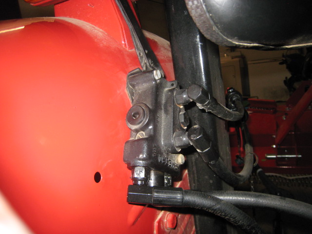

def38, can you take a few more photos, it looks like the opposite side of where your hoses come into the valve, looks like a plug. Take 4 photos of each side... I'm thinking the valve will work but it needs to be plumbed correctly.

#38

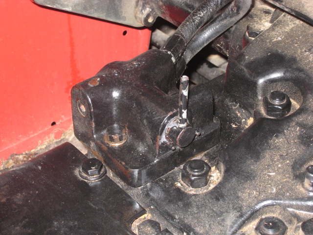

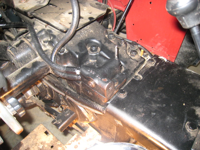

Additional photos attached.
I swapped the hoses at the rear and no change. I'm baffled.
   / What is this thing? How does it work? #39
The first thing I would do, is to remove both hoses from the valve on the transmission to the valve on the fender (at the fender end), then stick both of them into a clean five gallon bucket and start the tractor. One of them should let out fluid. That one should go to the in port of the valve on the fender. You should be able to blow into the other one if you have the three-point hitch levers all the way down. That one should go to the out port of the valve on the fender. While you have things apart, make sure you can blow air from the in-port to to the out-port of the valve on the fender.
