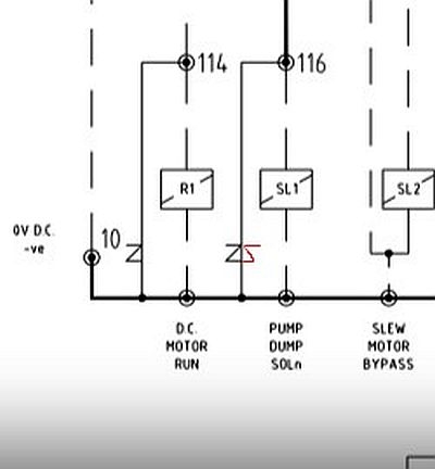

What is this symbol
   / What is this symbol #11
Once I knew I was looking for a diode I found them on the control board in between and around the relays, but they're hard to see without a good flash
Those are relays not diodes. on edit I do see the diodes.
I think all the Z lines go off page probably to a computer test plug.
Line 10 is signal ground -VC 0V and may or may not be connected to chassis ground and line 4 is +VC 12V
My guess Z is not a electrical component.
   / What is this symbol #12

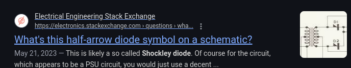

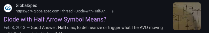

Maybe its not a "Z".... Maybe its half of a (flyback) diode symbol....
Look up "flyback" diodes and you will see how they are wired across relay coils...

Foreign drawing so all bets are off...as others have posted earlier it can either be a zener or other specialty diode, or an MOV. Bottom line it has to have high impedance under normal voltage conditions, and break down to a low impedance if voltage spikes high. In this circuit you could substitute an ordinary diode, like a 1N4001, with the cathode (banded end) facing the 12V power supply (up) if you felt you needed to replace it.
   / What is this symbol #17
In all my years as an electronics technician, and plenty of time troubleshooting automotive, farm and industrial equipment electronics, I have never once seen that symbol used as a symbol for a diode on a diagram. However, from their placement on the diagram, those are obviously ordinary diodes used to suppress the generated voltage when a relay switches from on to off, or what some are referring to as "flyback". It's a very common practice in design of electronics with relays and solenoids. I'm guessing that drawing was made by someone not very knowledgeable about electronics drawings.
