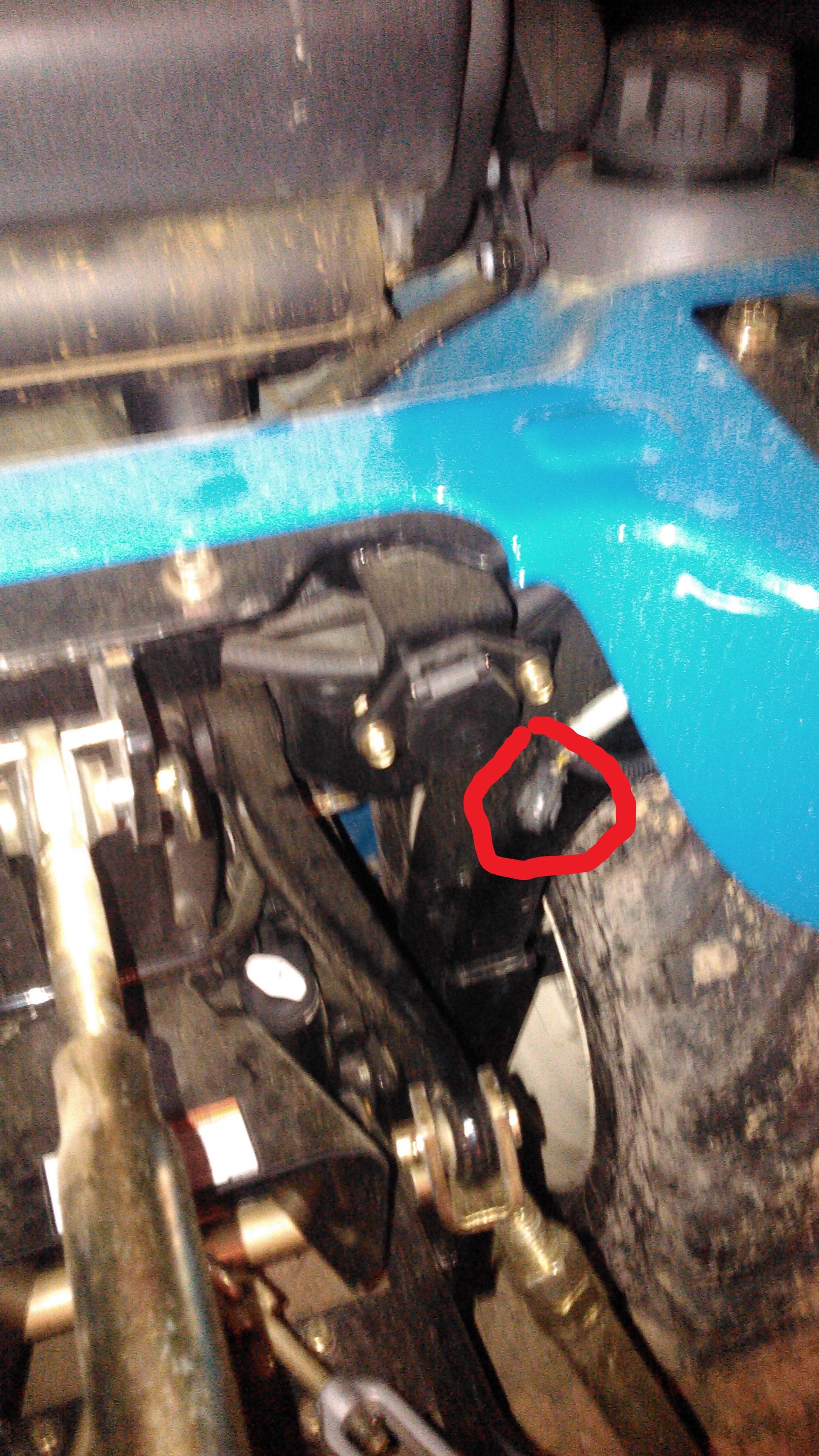

LS MT125
2 wire plug, comes out of the wire loom with rear lights, next to 7 wire plug

I don't know if yours is the same as my Kubota, but mine was pre wired for future lights.
/ What is this plug? #4
Pretty sure that is a wire for the license plate light. I'd imagine Europe uses that connector.

Thanks, I need to go out there with a test light and see when it has power
don't think it has power without key on...

How 'bout that? Saw the thread title and thought, hey, I should ask about the one hanging under the fender, only to find out that's the one you're asking about. I was planning on testing it for juice, but I haven't really needed it yet. I get everything I need out of the trailer connector for now.
I got an led worklight for the back, if this plug has power with key on, I'll probably
use it. But I am not gonna waste half a day trying to find a matching plug, will
cut it off and wire in something more common
This plug is only powered when engine is running,
so I am not sure what it was intended for

Must be something added to the newer 125's, I searched and searched....can't find it on mine. I probably wouldn't use it anyway, I added switches up front w/ blue LED "on" indicators for my LED flood lights, and backhoe LED worklight. At least on mine, LS "prewired" the backhoe light and coiled up enough wire to run up to the battery area. I used relays and fuses for the lights, keeping them in the battery area.

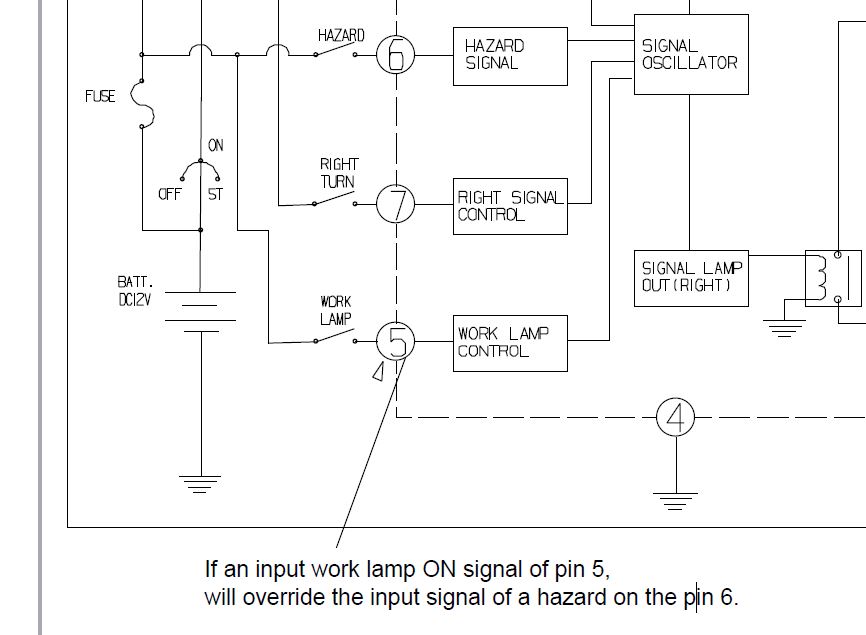

Wow .... umm.. I forgot I had one. Dealer gave me a thumbdrive and I never really looked at it before. Guess what it's for. Nyuk, nyuk, nyuk ....
No idea where the switch shown in the schematic might be though.
Edit ... Not a switch. Those are the relay contacts shown. Still can't find out how that plug is turned on or off.

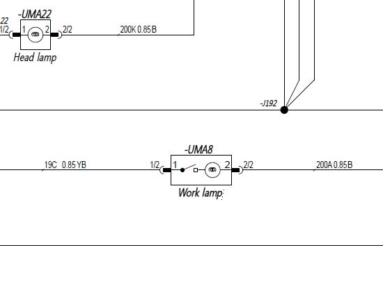

'Nother Edit ...
Looks like it's just 'hot' when the key is on and uses an integrated switch in the lamp assembly:

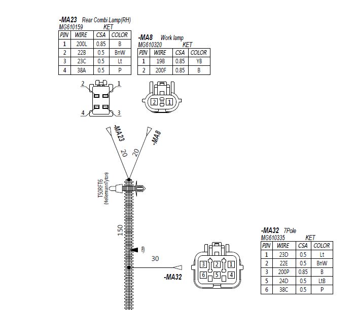

/ What is this plug? #13
Reading further, I also have a complete parts manual with exploded diagrams. It shows the work lamp assembly with the mating connector.
/ What is this plug? #14
Mine is a standard SAE hot plug. I use it to power the rear work/flood light.
