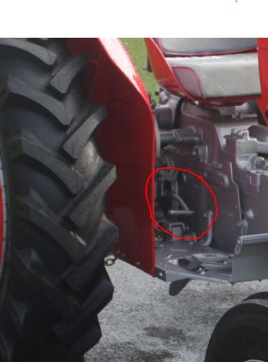

I believe I have every button, pedal and lever figured out on my MF205, but there is this one pedal that I have no clue about. It's down below the seat and not very accessible, but looks like a foot pedal. Here is a picture:
   / What is this pedal #2
My guess it is a brake to lock one wheel or a differential lock.
   / What is this pedal #5
and a very useful pedal that diff lock is too! I find it can significantly improve stability and safer traversing of extremely uneven ground.
   / What is this pedal #6
Especially with a 2wd tractor!!! :)
