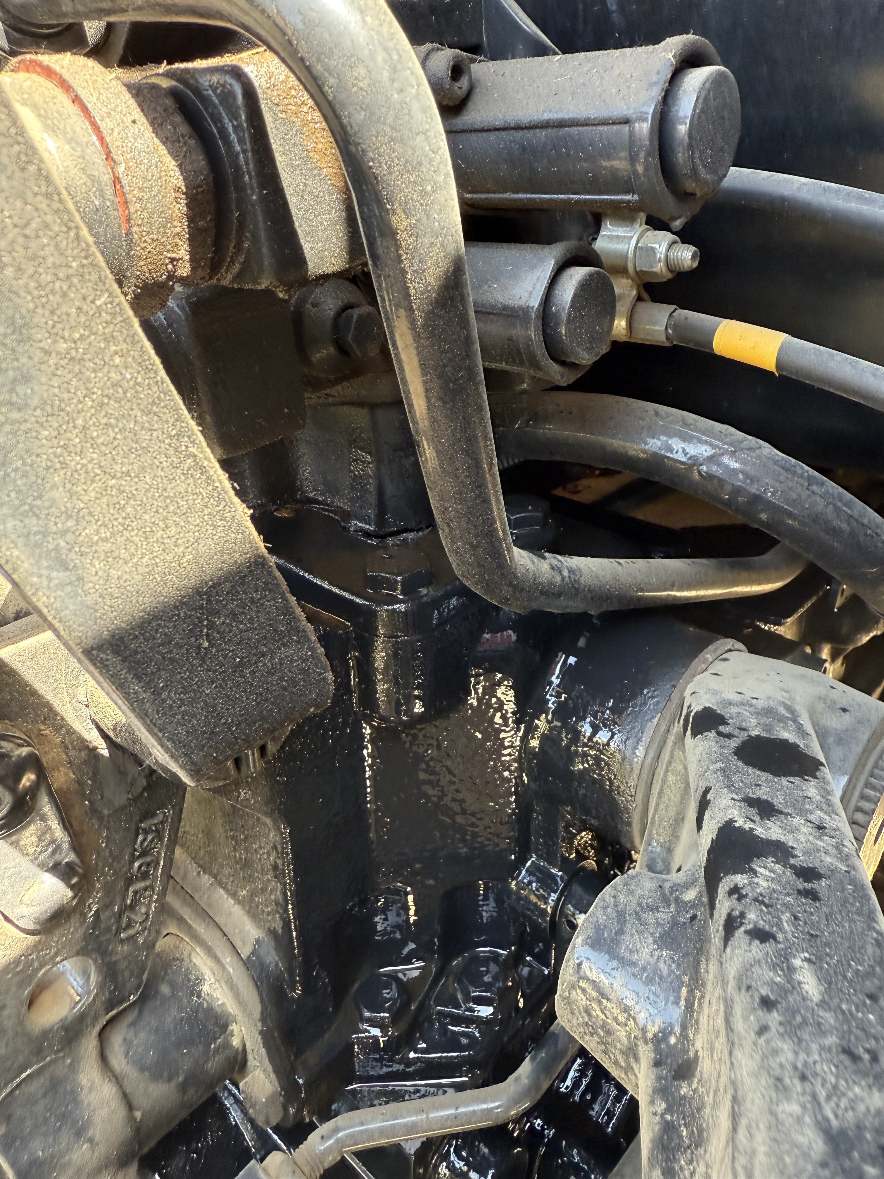

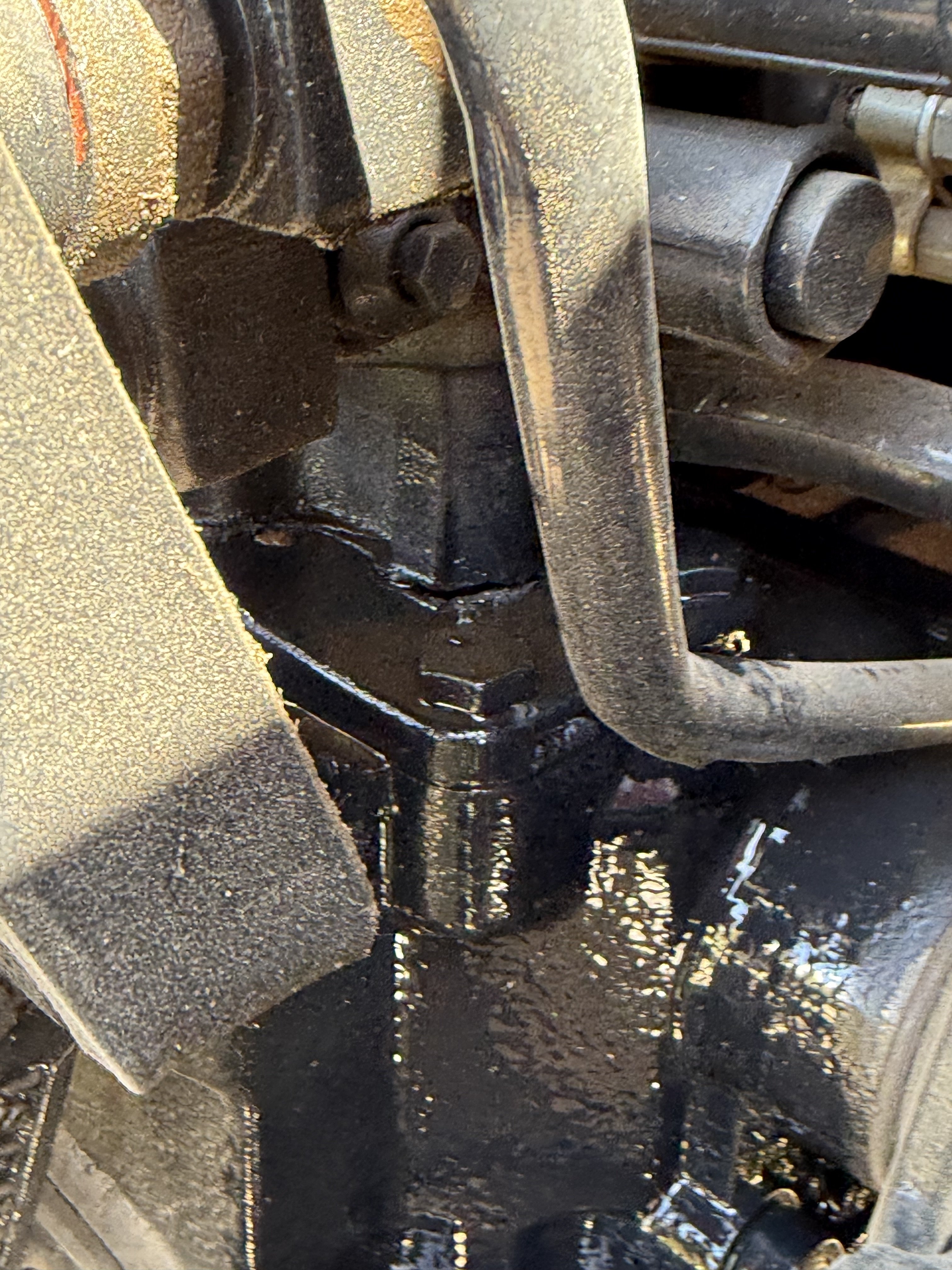

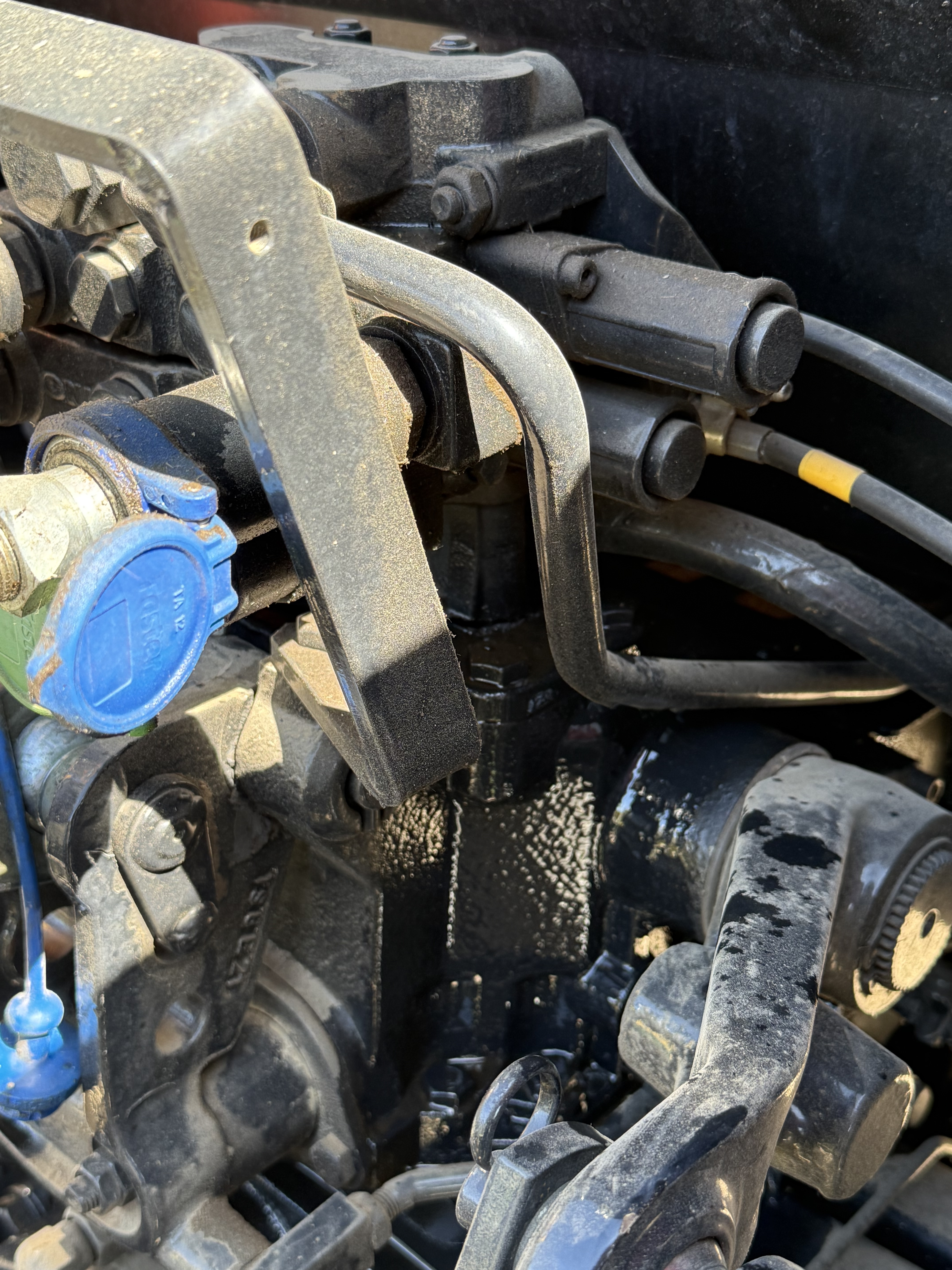

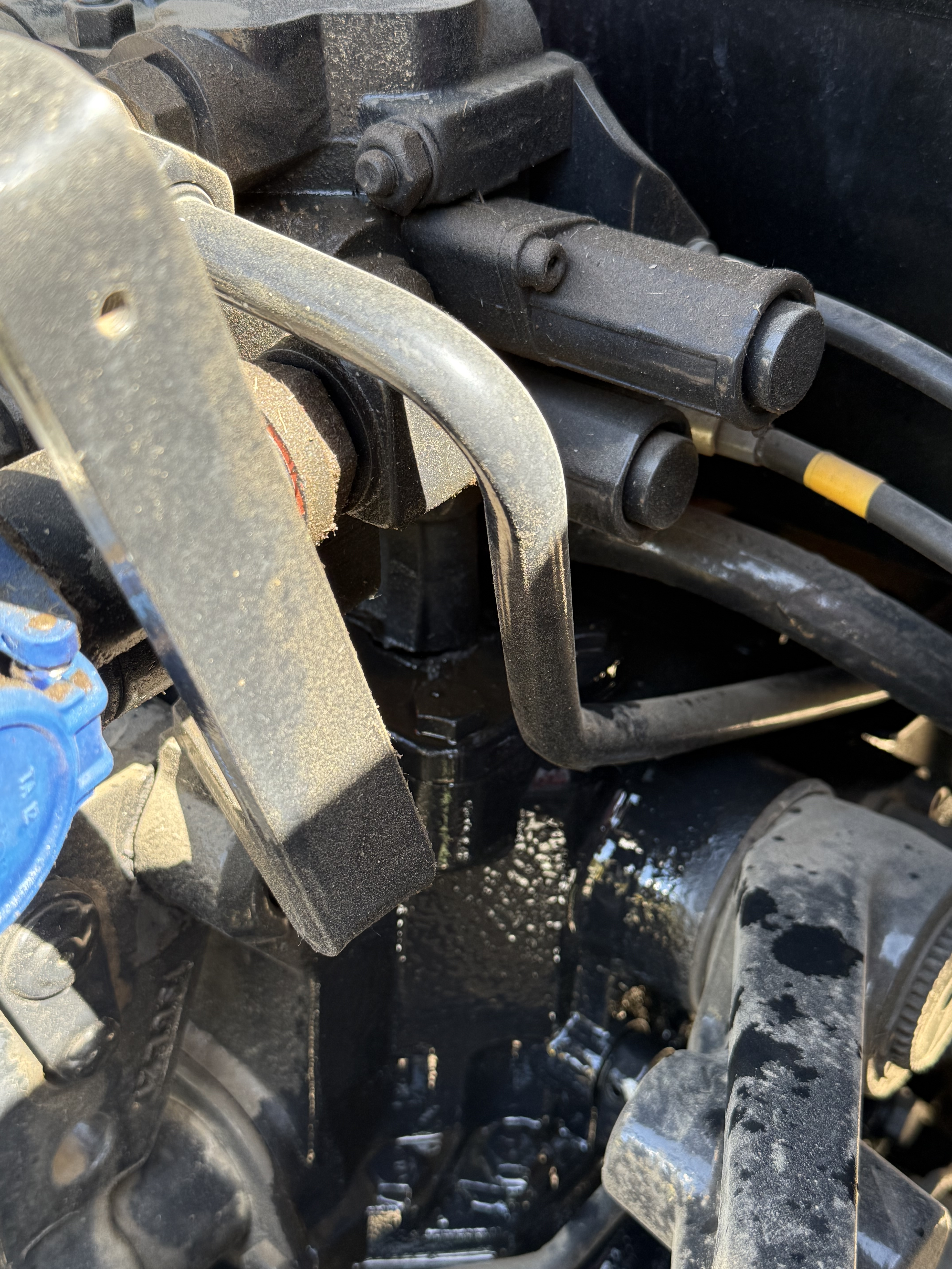

What is this part? The rear remotes attach to it. I noticed today it was cracked with fluid running out of it. The tractor has less than 600 hrs and is still covered by warranty. I don’t run much off of the hydraulics. Most of my stuff is 3 point, but is there anything I could have done to have caused it? Also is this an easy fix, this is a busy time of year for me and I really need the tractor. The tractor is a 2023 Case 75c

Looks like it could be item #27 in this diagram. Could you have done something to crack it without knowing? Possible I guess, but doubtful you could do that with damaging something else nearby. I would think there would be some signs of impact damage somewhere as well.
   / What is this part on my case 75c
That definently is the part. Thanks. No, there wasn’t any impact. I’m wondering if there could’ve possibly been something run on it that created too much pressure for it too handle.
   / What is this part on my case 75c #4
I doubt that. There would be a history of failure if so. I think it was a simple case of part failure and warranty should be no argument.
