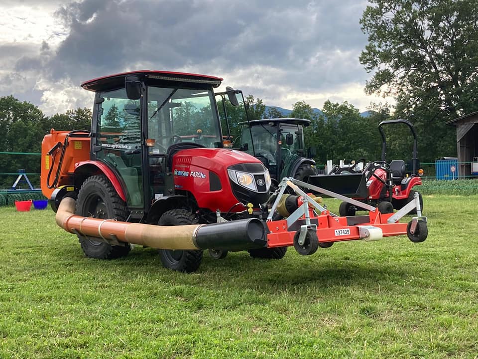

In Europe, that would be an easy find. Front 3 pt + PTO is very common from smaller tractors (usually 30HP) to the bigger ones.
In the US, not so much but there may be other solutions, like the Ventrac tractors and stuff like that.

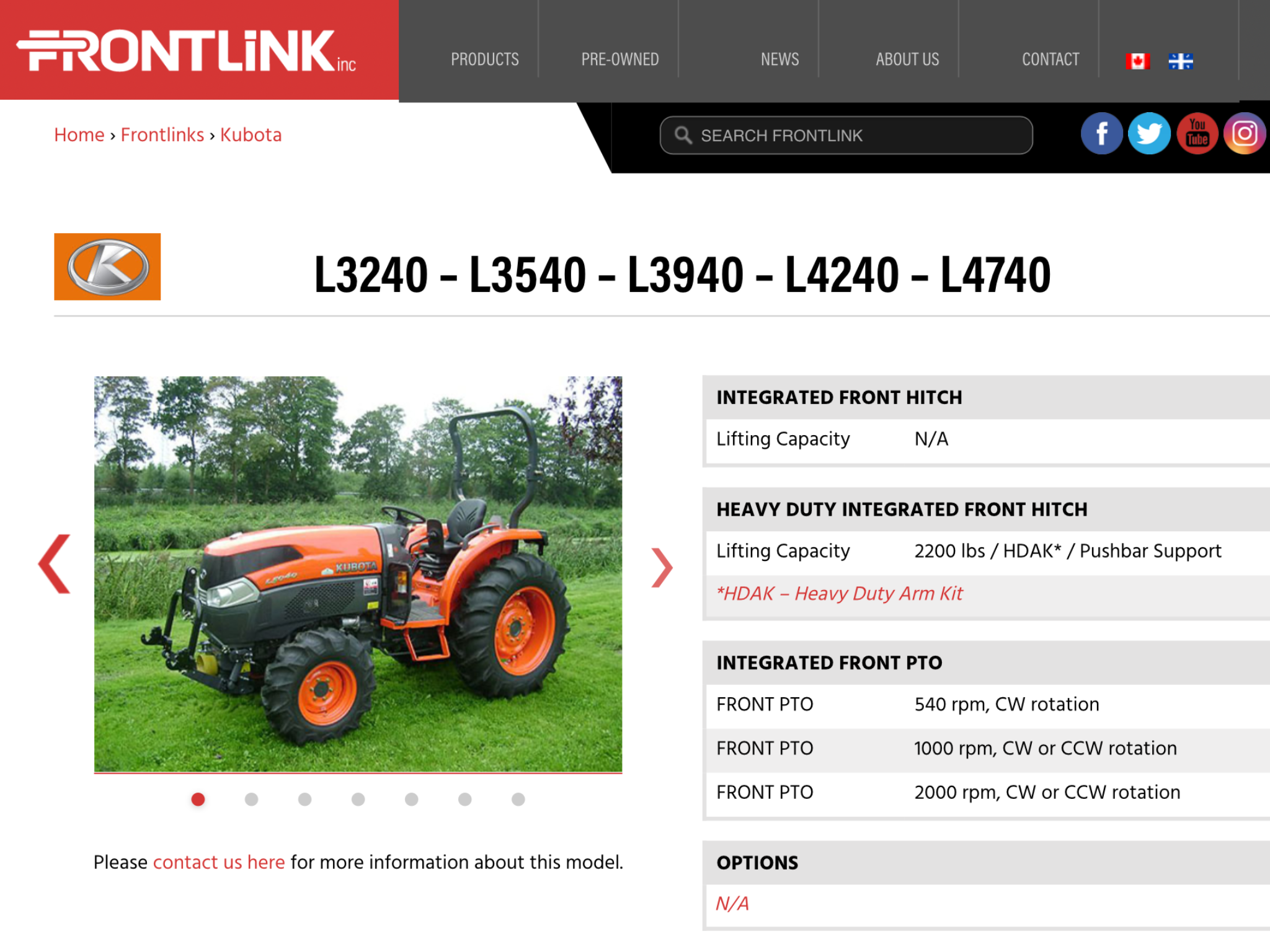

Try Googling “Front Link” to see if they make one for your model. Looks like they may have one for the
late model L series.

The Kubota system is pretty sweet, but appears to be only for the 60-series. I have a 40-series. Also it is not for standard cat-1 implements.
