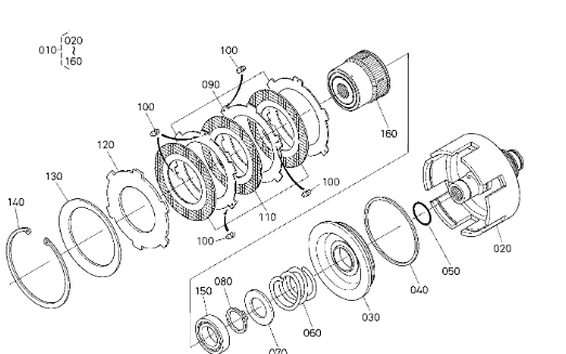

My Kubota M6040 has an independent mechanical PTO. Very handy - separate lever engages/disengages the PTO. I engage at dead idle - the PTO lever allows me to "slip the clutch" for even easier engagement.
I think the pto clutch in your M6040 is hyd operated not mechanical.
