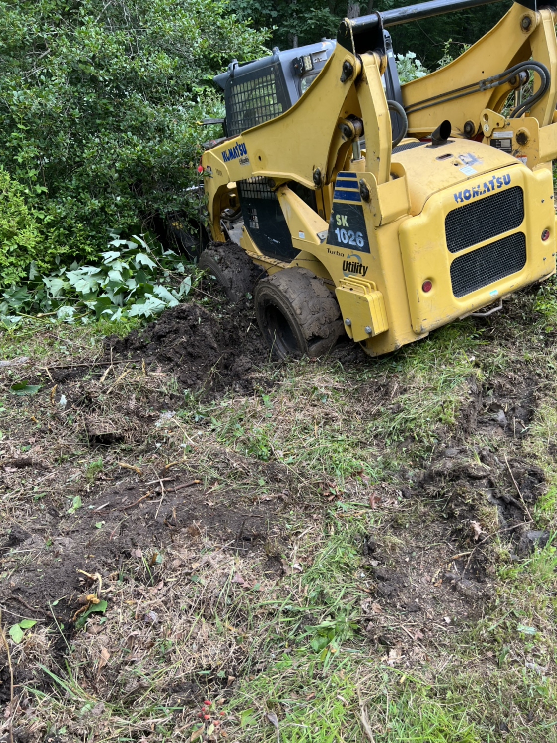

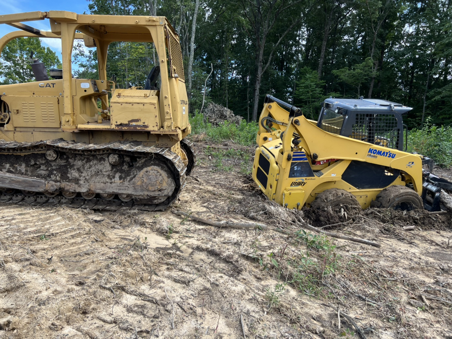

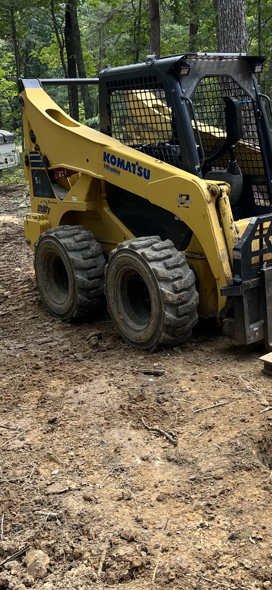

I own a wheeled and tracked skid steer. The wheeled machine doesn’t do well in soft ground. If the ground is fairly firm but muddy on the top it doesn’t do well. It also rides like a pogo stick. If you’re working on fairly smooth and dry ground it’s a capable machine. The tracked one is a completely different animal. You’re not buying a tracked one that’s not at a fire salvage sale for $15k but a tracked machine is very capable. A tracked skid steer will make a tractor look silly. The wheeled machine will still outperform a tractor on dry ground. The tractor wins in mud. You can run steel tracks on the wheel machine to help with the mud. I don’t have them on mine because I don’t like them for one thing but I drive the machine on roads and driveways so steel tracks are out of the question. View attachment 764545

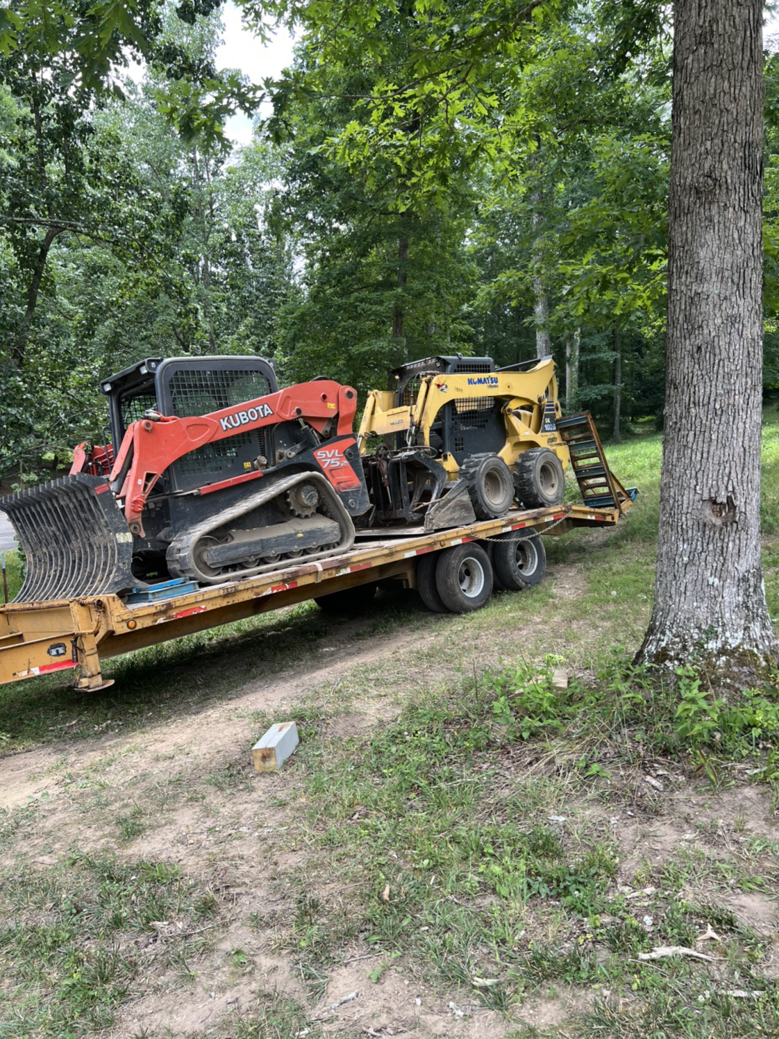

My Komatsu is open station and my Kubota has a cab. The cab is way better. Just for a little bit I’d sell the Komatsu and buy something with a cab. The Komatsu is a nice pre emission machine otherwise I probably would have already done that.
