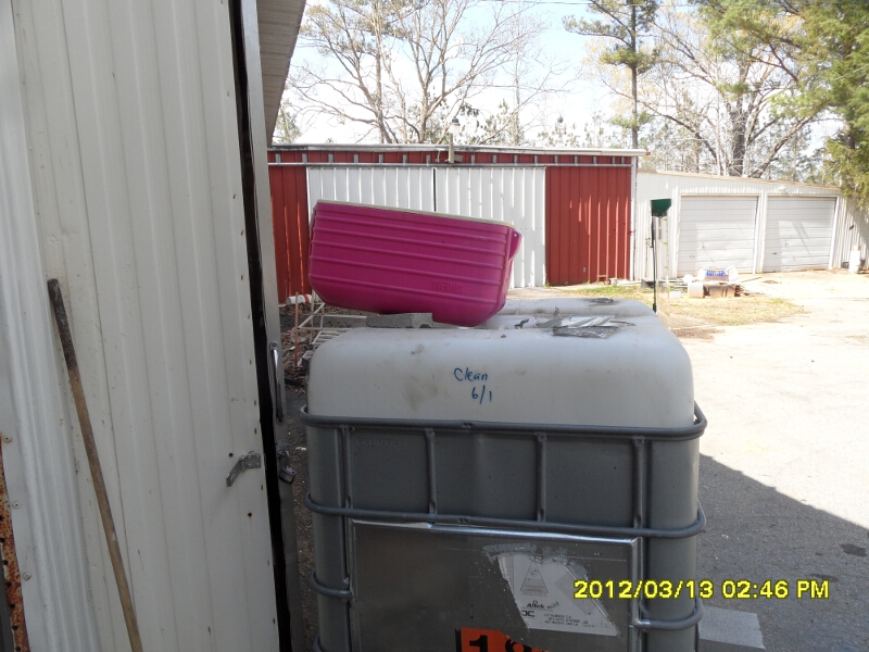

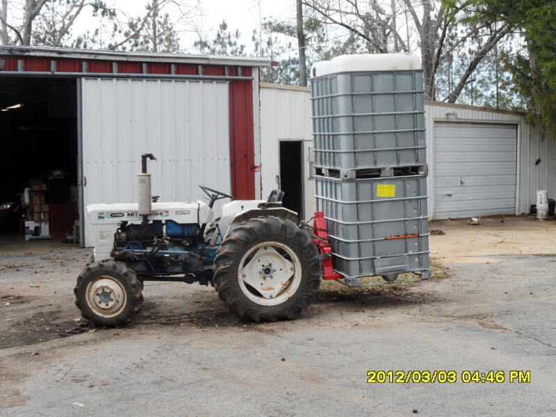

First the well - Forget about it. Get yourself 1 or 2 IPC totes.
Pic of my simple rainwater collection method:
Moving two empty totes:
These can be had easily for $100 each, sometimes FREE (Thanks Taylortractornut) and hold about 300 gallons each. Fill them up when the power works and you've got plenty of water for $200. And maybe a rain collection system.
Around here (Knoxville), I regularly see those 300 gallon totes, with the metal cage included, for $75. That just seems to be the going price.

But I wanted to point out that if you NEED typical EMERGENCY water, say 50 to 100 gallons/day (forget the long baths) a couple of IBC totes could replace $1,000 worth of generator capacity. And if need be you could wire it so you could switch off everything else and switch on the pump to just fill the totes.
