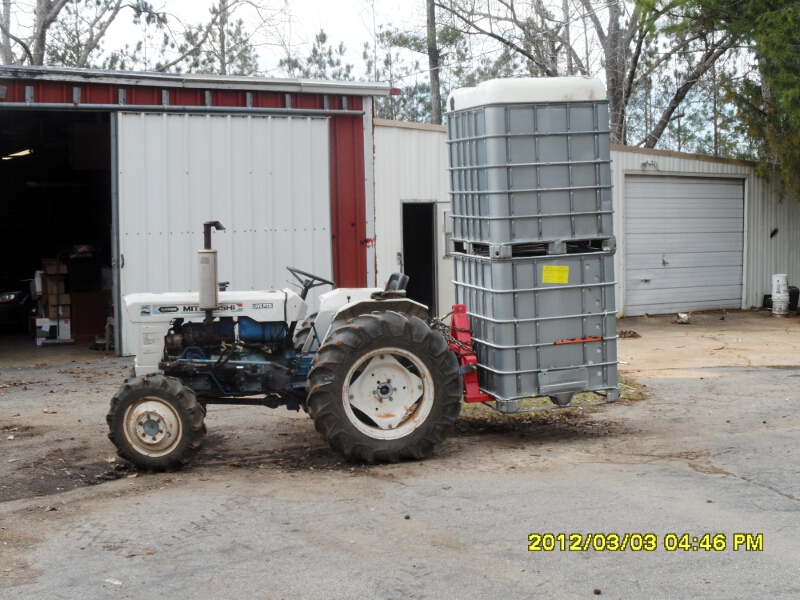

That's one reason I recommended the IBC totes and collecting rainwater.
That is easy storage for 500 gallons for minimal cost (/edit - mine were free). If you have acreage storage should be no problem. If you have a tractor movement of one of them (partially full) on a pallet isn't that difficult. And you fill them when you get them, not after the emergency starts.
