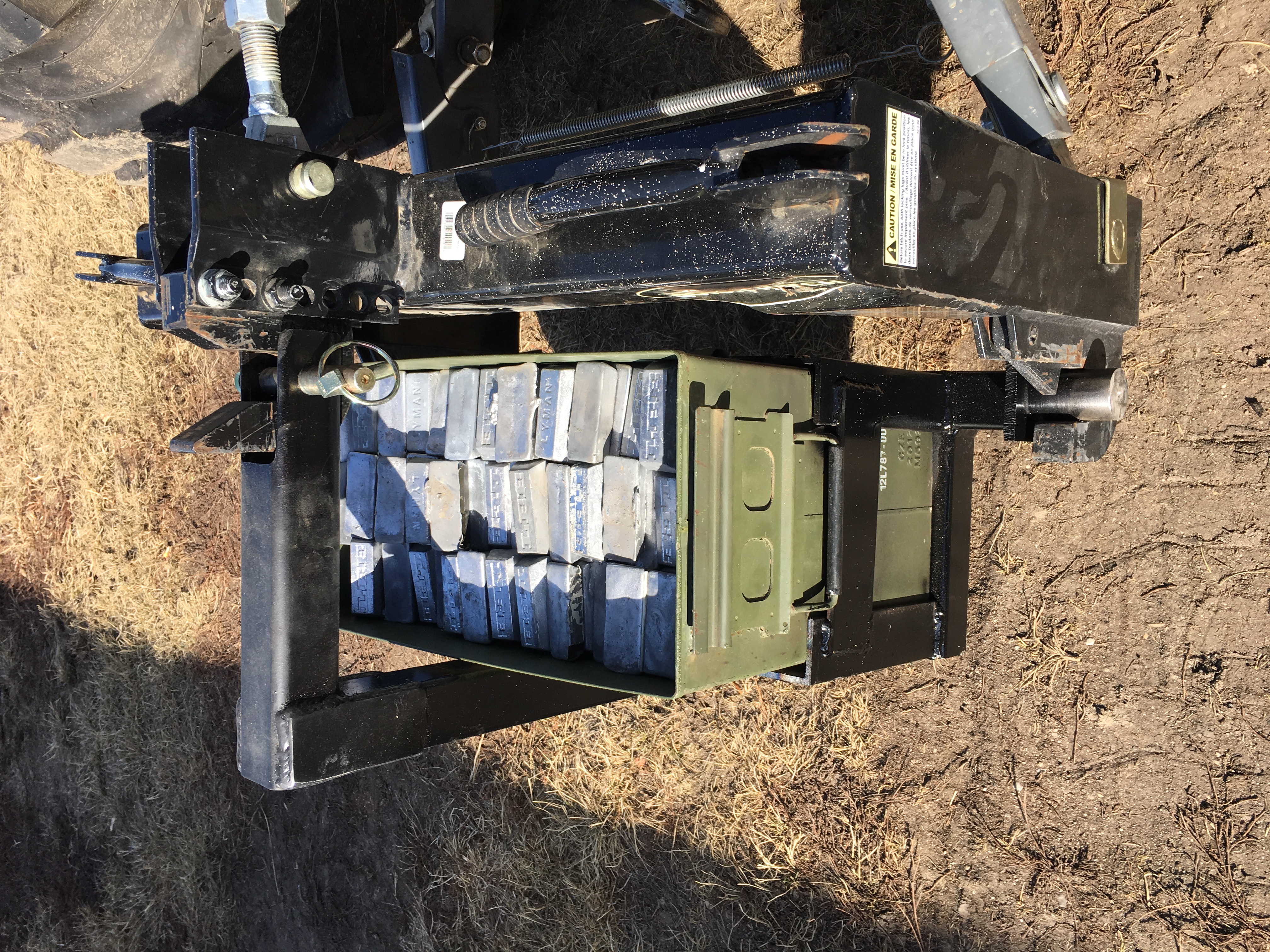

Regarding ballast...I want safety over everything else. I use washer fluid in my rear turfs and a ballast box I made to fit a carry all. The ballast box has stringers on the bottom so it can easily be set down and I can use the carry all for other duties. I use a ratchet strap to hold the ballast box onto the carry all.
It took about 4 hours to make, and I used 500 lbs of lead ingots in the back of the box. That left about two feet of storage area in the box for tools and chains.
Where did you find 500 pounds of lead ingots?
Bullet caster here wanting to know.

I have over 3000 lbs of alloy....I cast a few bullets as well....LOL
Anyway, I will be replacing my precious lead with that useless Zn they are making wheel weights from, but I had lead when when I built the ballast box.
For those who do not know, lead has over four times the density of concrete. If you can get lead or zinc, it will save a lot of space if you want a compact ballast box or if, like me, want to use the ballast box for more than just ballast.

Just built my ballast box. Close to 600 ingots, carefully placed in the box. Easy to get a few if I need to cast some.44 cal. 6AE1DE94-1DC6-4864-A028-B035380C7D16.jpeg
