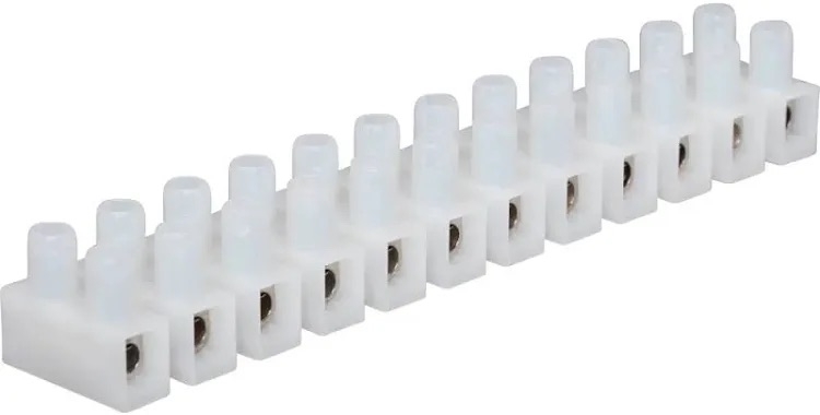

I used a lot of these working in Austria… very secure but I found a little more precision needed removing insulation plus time to screw down the set screw.
