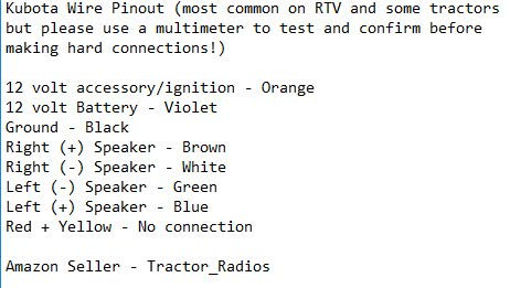

I added an aftermarket radio on my L6060HSTC and used this wiring harness:
The pinout looks like this:
I find the cab too noisy to listen to music with the OEM speakers. The aftermarket radio I use connects to Bluetooth headphones which works out well for me. I can still monitor the tractor & implements for problem sounds.
