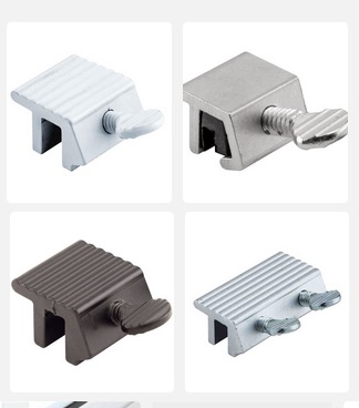

Before I head over to the store, I thought I better know what the part is called.
I am looking for a stop block that I can mount on the metal surround by the height adjustment lever for the 3 point. When I have my mower deck on, there are times that I need to raise it to clear elevation changes or during tight turns to keep the deck frame from digging in. It would be so nice to have a stop block that I can set at the lower height setting and just push it to the stop.
Does such a thangymaboper exist?
   / What is it called #2
A bolt with a knob on it, washers top and bottom, tack weld a nut on a washer with edges turned up into the slot lever moves in.
   / What is it called #4
Maybe a sliding window lock would work.
If you need larger or stronger, maybe use a beam clamp.
beam clamp at DuckDuckGo

Thanks, that gives me ideas and a direction to go.
