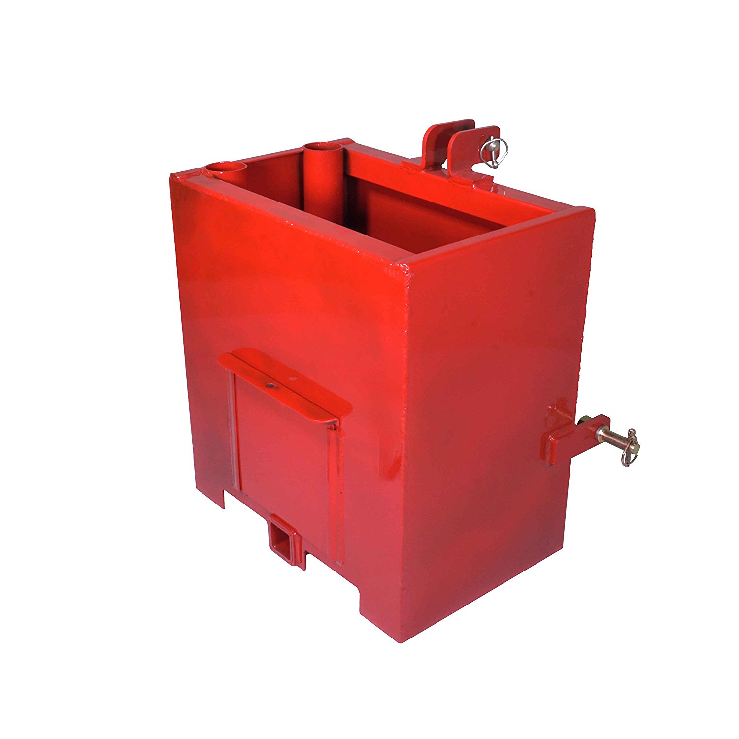

I have this Titan box from Amazon. Specs say it weighs 132 lbs, has 800 lbs capacity, and holds 5.3 cu ft. Will be lifting heaping scoops of red clay fill dirt to max height, so appx ~1/2 yd. So I'm guessing I want that box as heavy as I can reasonably get it - without putting a fortune into material. Have a few scrap yards nearby so will ask around if any get a lot of metal slugs. We make insane amounts where I work punching copper - 3/8"-1/2" diameter, 1/4" thick discs. That would be perfect, but since we get a LOT of $ per lb for scrap copper (almost as much as we pay for new raw copper per lb) I'm sure they would frown on me helping myself to some :)

Probably one of the easiest and cleanest looking weights that I've seen added to the rear of a tractor was lengths of rebar on top of a box blade. Just keep cutting and stacking them until you have enough.
I don't have a loader on my tractor, and I needed more weight up front, so I found a free big rig brake drum and bolted it to the front of my frame. I put some broken up concrete and rocks into it, and it's worked great.

I've been collecting 42 lb tractor weights over the years and found that 13 of them fit perfectly in the bottom 1/2 of my Titan ballast box leaving the upper 1/2 open for tools, chains etc. Easy to remove when I need some on my garden tractor.

I read here on TBN that Portland Cement is heaver than premixed concrete, so that is what I used. I added some scrap steel I had laying around and filled it to within 10 inches of the top for about 600 pounds. I use that with the snowblower. When I have the pallet forks on I add another 300 pounds of wheel weights and flat bar steel.
